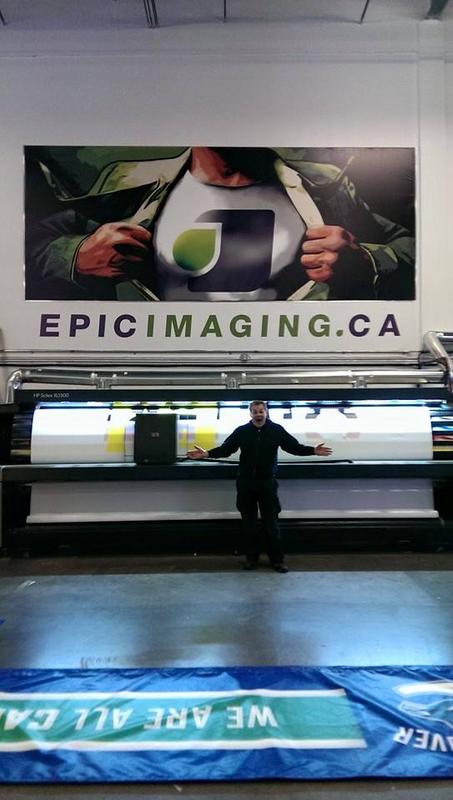

Hello All!
We just got an HP Scitex XL1500, the 16-foot wide model. We are making headway in getting profiles and colors working. Just wanted to start this new thread to draw some tips and tricks. I know it's an older machine, but it's still roaring away! Post here if your shop is still running this machine.
Thanks!
- Doug
Vancouver
