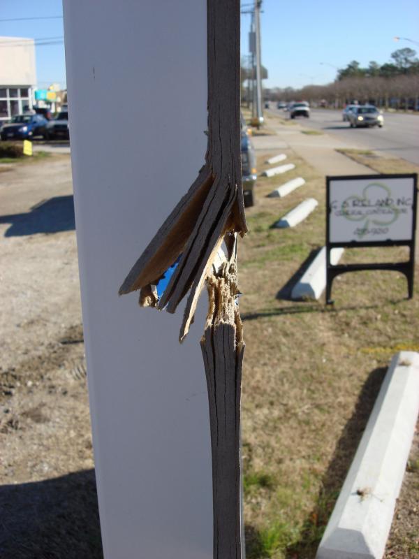

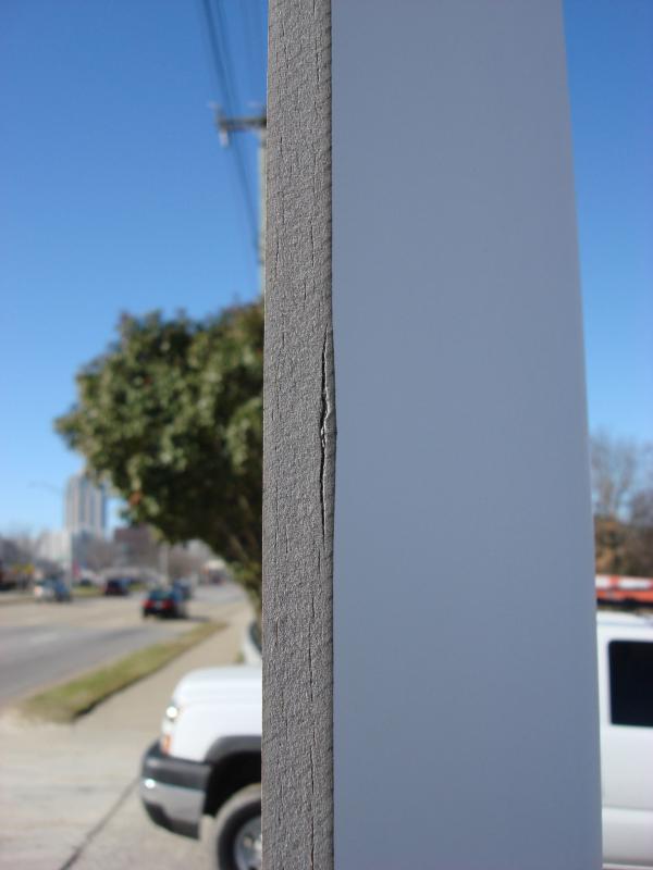

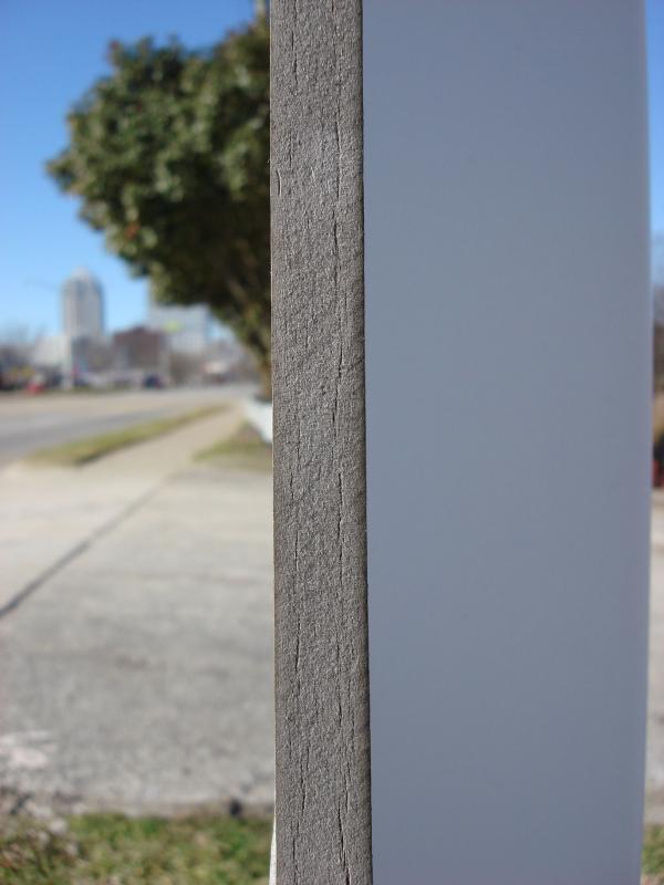

Much Like Bigdawg, we soaked a piece in water for 72 hours before we decided to give it a whirl in the real world.
Ironically, i just went back to a sign i did about 8 months ago with scooter board and took some pictures to see how it held up.
This was for a medium term construction site, done in 1/2 Scooter Board ... i failed to paint the edges (i know, i know)
The pictures below give you a good idea of how scooter board is made, basically layers. This is the condition of it after 8 months in VA weather.
The huge gash was done by a front end loader.

phototec
Chad.;485171bo This was for a medium term construction site said:
Chad, I have a question you said you failed to paint the edges, however in your photos the edges look gray, is that how they come from the factory?
