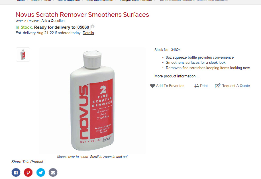

We've used this and depending on the depth of the scratches, it might what you need.

That brand also has a #3 for heavy scratches. We also use Mother's Plastic Polish or Zymol Cleaner Wax.
I've experimented with those wipes for rejuvenating the lenses on headlights and it works ok.
