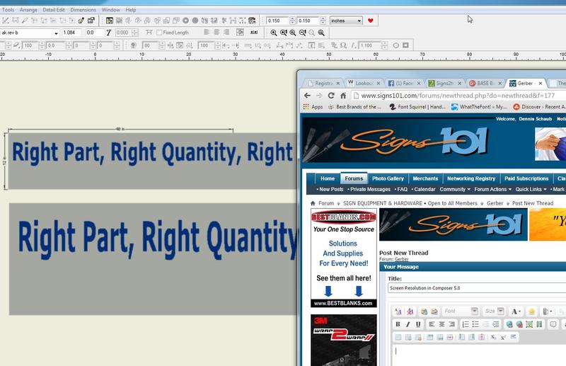

I recently upgraded my graphics computer and upgraded Gerber Composer as well. Everything is working great, but for some reason the graphics in Composer appear fuzzy/low res, while graphics in other programs appear sharp? Not sure why this would be.

View menu, click "show smooth drawing" (at bottom of fifth group). If it turns on after closing and re-opening Composer, make sure you have the latest version of Composer. One version back they had the problem that the smooth drawing would always be on, and you couldn't turn it off. The latest is Composer version 5.0.0.1370.
