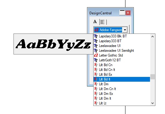

With Flexi, is is possible to use SCF-Fonts (old Casmate-Fonts) too, so you do not run into trouble when the files contain them. In the Flexi App-Folder is a Folder CASFonts, just copy your SCF-Libraries into that folder. Casmate-Fonts appear in the fonts list with a icon consist of two letters "f", one grey, one red (like the old Scanvec-Logo-Colours, see attached picture). As far as I remember, some basic SCF-Libraries are delivered with every Flexi-CD up to Flexi 10 or so (not shure).
Some very old libraries have problems with some special national characters (like äöu in german).
