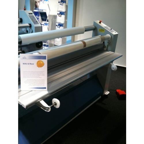

How is everyone feeding there 54 base when doing long runs? Does anyone know if seal sells the front table feed roller for the 54 base? I've only seen it available for the 62. Here is a picture of the 62 base front optional roller.

We feed our 62 from the back bottom spindle.
You can then set the tension similar to the laminate.
With the takeup reel fitted running whole rolls is easy.
chafro
Same here. And we constantly do complete 170FT rolls with no problem.
sometimes feed manually when rolls are 1/4 or less in length.
31legen
Front feed
It seems like it would be much easier to feed and run pieces 20-30 ft with the frt table feed roller.
