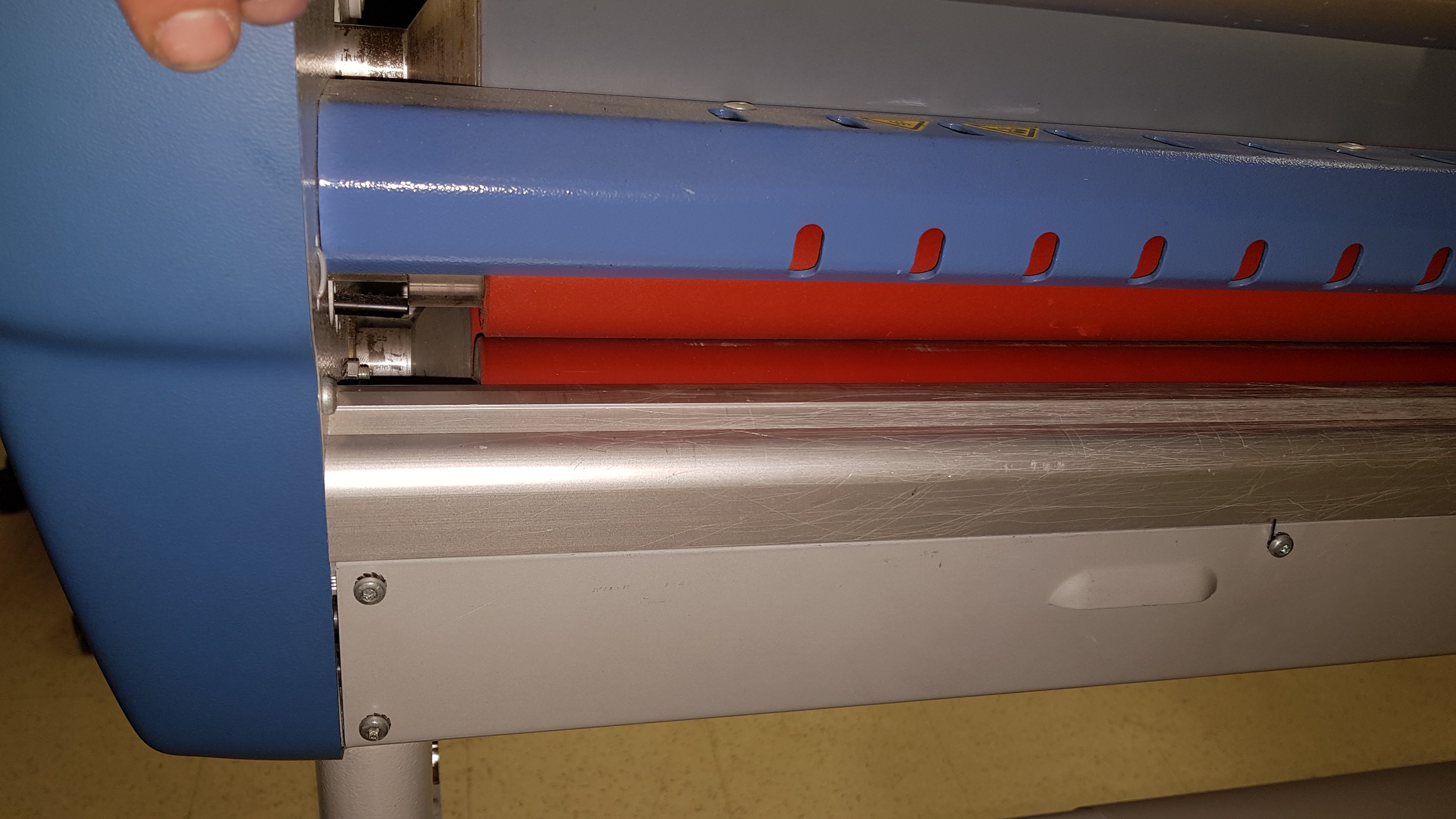

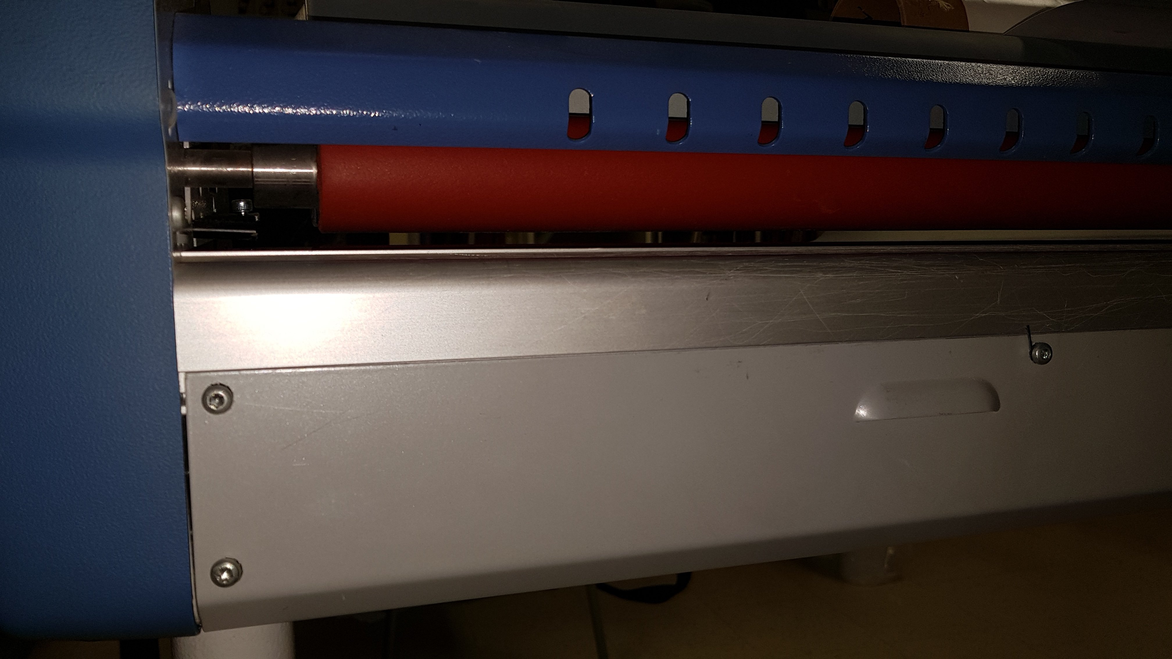

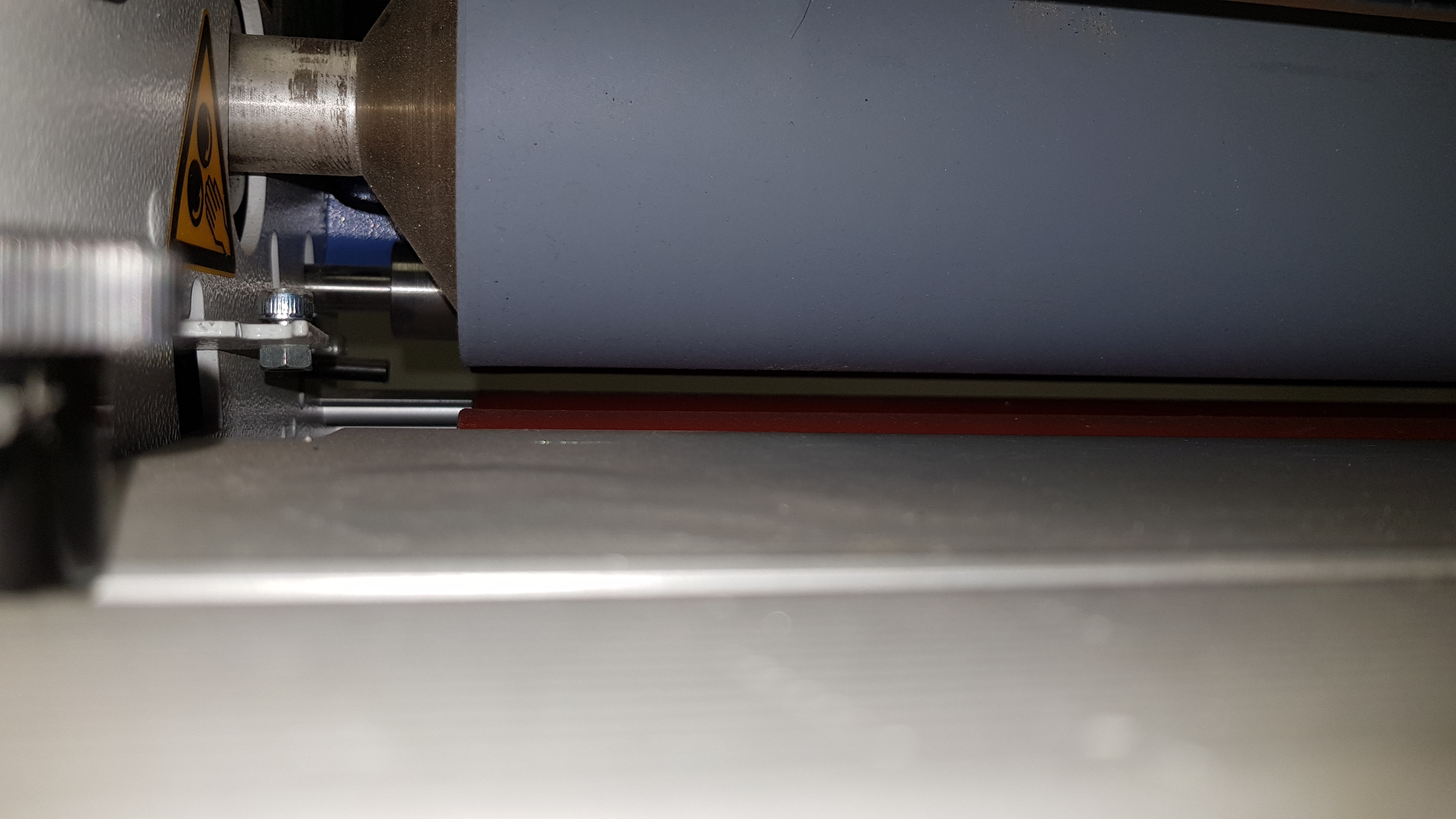

yes, but other laminators has nim 2-3cm wide... so, you can easly grab laminate in pull it throu... When i have a nip 1cm wide, i have trouble when laminte sticks to lower roller...
i have some rollers in the back, with foam around them... that nip is even smaller... i hardly get forex 4mm throu. without these rollers it would be much easier.
i did some pictures what im talking about...
edit: damn flash... ok, i hope you will understand what im talking about... :)

Hmmm...I could have sworn that thing went up to 1/2". Used to run one and never had any issue threading anything through.
