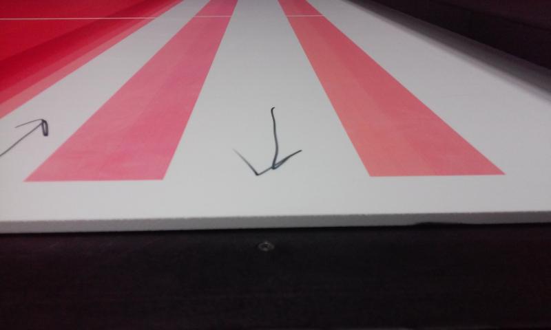

Here was another observation:
If you refer to the attached photo, I managed to catch an entire pass of a left and a right pass of the red. What is up with the color difference in passes based off of pass direction?
MrNick86
Sorry, the photo did not upload for some reason,. Trying again...

Looks like your yellow is acting up too. Does your printer have dampers? If you pause the printer right before the dropout and run a purge what happens? Does this extend print time before the dropout?

However, that separate color between passes still boggles me.

as for the change in pigment from left to right vs right to left that is metamerism caused by the head order in bidirectional mode. in one direction the fore head vs the aft lays down dots in a different top to bottom order. so left will have yellow dots on top of magenta dots and the other direction will have magenta on top of yellow dots.

Hi does this machine have led or lamp curing?
If lamp curing lubricate the shutter solenoids they may look like thay are opening and shutting poroperly but thay may not be.
I had this same issue on a machine that would give very different results in either direction. changing the lamp before or after switching gave very different results and it was actually better with the lamp turning on before curing, which goes against the general rules.
After finding that the lamp shutters were stcking and then lubricating them all was back to normal just like a new machine.
this machine had been used heavily for about 7 months before this problem happened.
