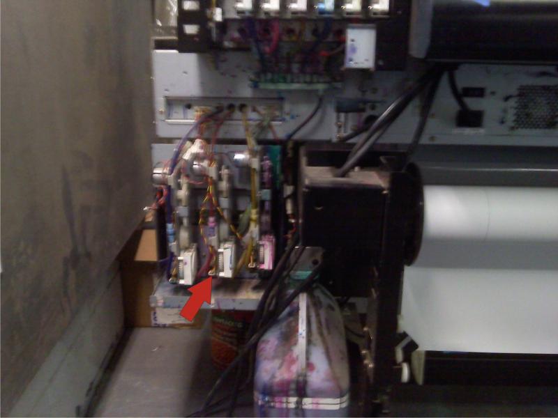

dont mind the mess LOL -- this is an OCE CS6060 which I believe is the exact same unit

the pin that punctures the cartridge appears to be fine, as the cartridge is punctured.
next, i took off that front cover to have a look, and i couldn't see or feel anything in the magenta lines.

I ran into the same thing, except with Cyan. I did actually have a clogged line down by the small pumps. Replaced them with a new part (but the tubes are too short so they're kinked up a bit) and I'm still getting the same error.
