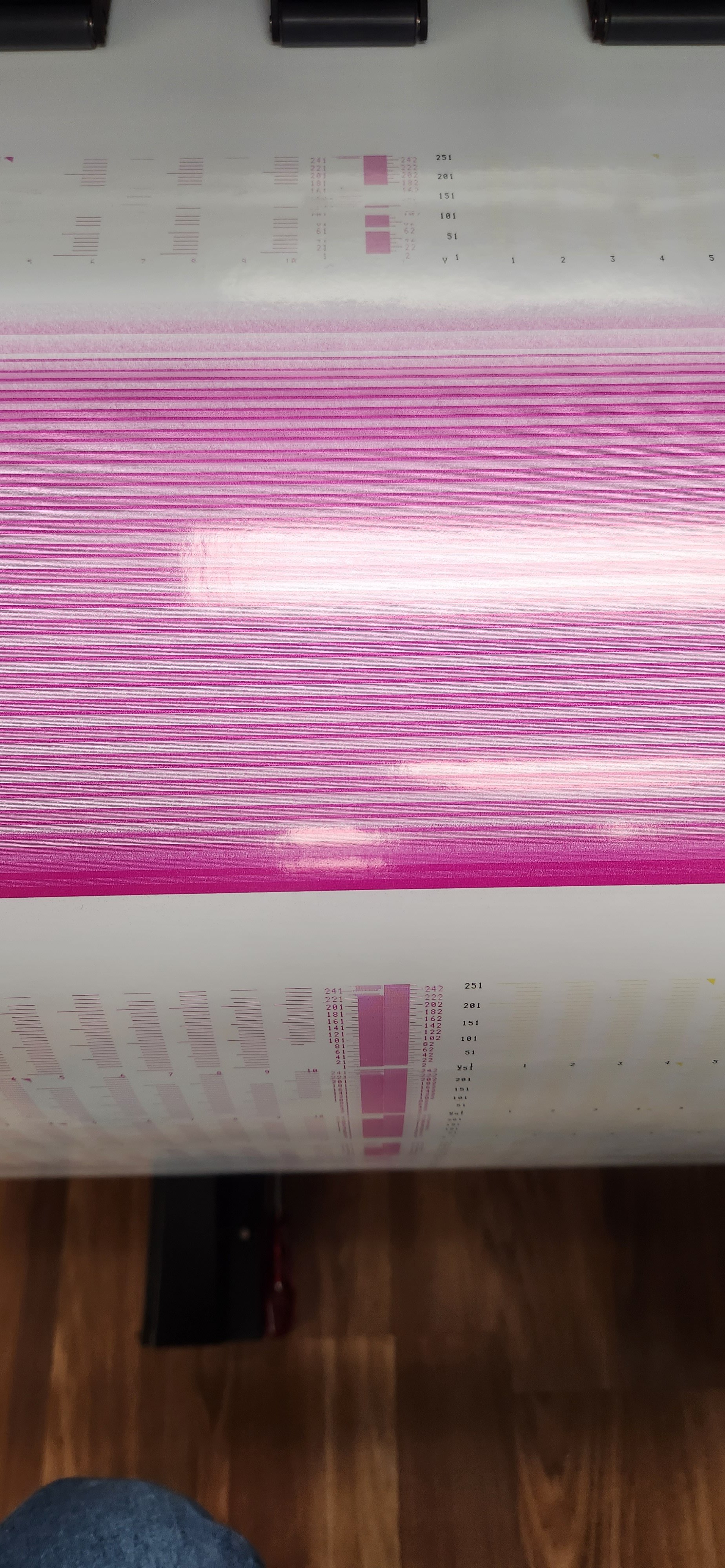

Been getting air in my Magenta line for a few weeks now.
Replaced
• Printhead
• Cap
• Pump
...only thing I haven't been able to do is replace O rings.
Where in the world can I buy these things?
I've been scouring the web for days to no avail.
Thanks in advance!

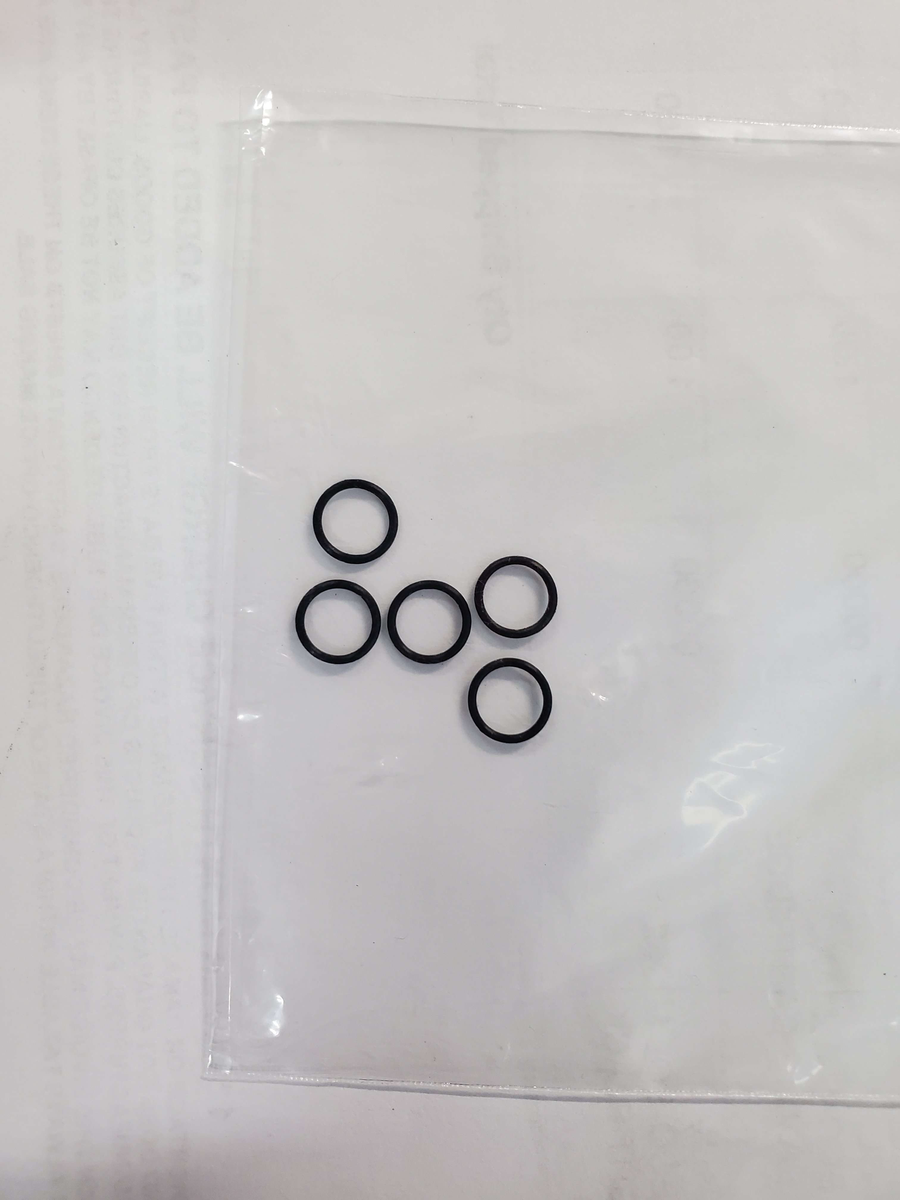

natallica
Graphics Guru
Are these what you're looking for?
I'm assuming so, the ones I took off of the hose ends were very small and thin, the one on the printhead was the larger/thicker type.
Are they all supposed to be the same size? If so, how many are in each line?
