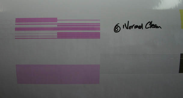

Does anyone have experience with having drop out on one head only after a cleaning. How to fix?

Also check the O-rings. I have one that prints a perfect test print, then hit print and she stutters a lot. In addition to the damper inline, there is also a damper in the print head. I have been told the only way to replace the print head damper is to purchase a new head. We have one machine we experimented with, and that solved our issue. I guess after 7 or 8 years they just get tired.
