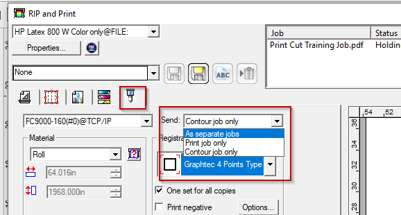

i'm running an HP Latex 315 Print and Cut system with Flexi Production Manager 21. I sent a job of 1.5" circle labels to print and cut but then realized that the CutContour line was not going to produce a full circle because it falls just slightly outside the edge of the artwork file (I made the file 1.5x1.5 when I should have gone larger). I then thought I could just redo the file with the same artboard size, but make the circle die-line 1.49 to fall within the artwork edge. I could then just use that as the cut file as the overall dimensions and the barcode setup would all be the same. No one would be the wiser. BUT... I can't find a way to just send this new setup to the cutter without it also reprinting. Is this possible? Any suggestions?
