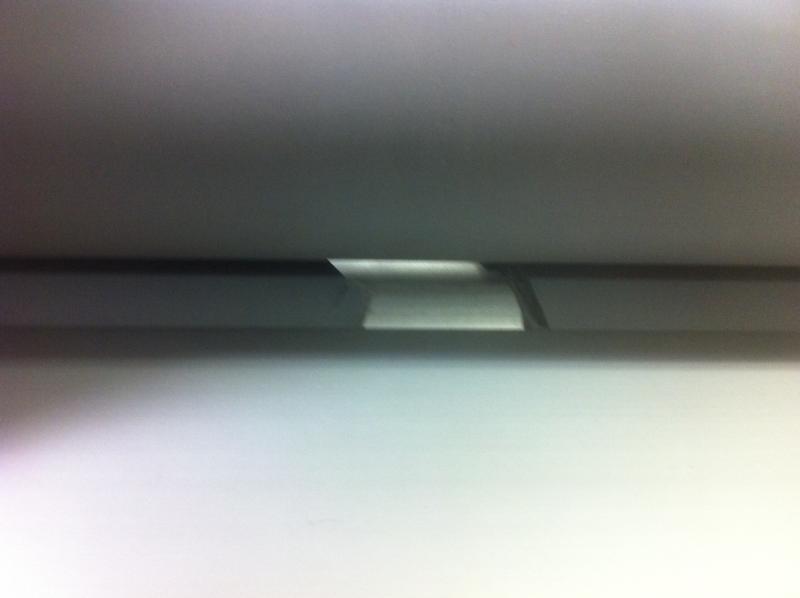

If it will cut you, it will cut your rollers.
