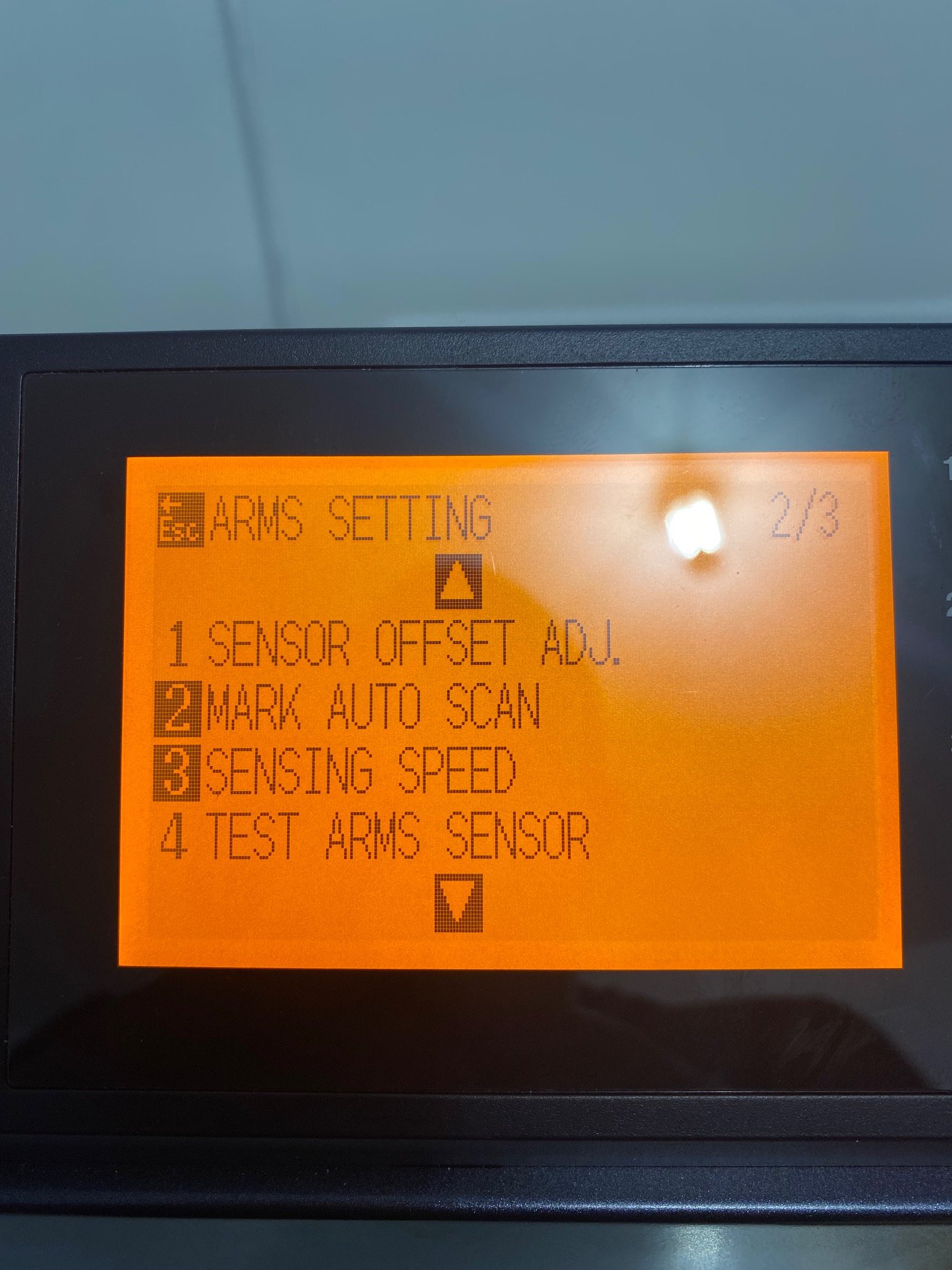

My general assumption is that you entered this screen by turning the machine on and then before loading
paper you hit the <pause> then the <2> for "Arms" and then the down arrow twice to get to this exact screen....  if this is correct, please repeat from the beginning, but let the plotter load a sheet or roll first.  then the option #'s 1 and 4 will be selectable.
