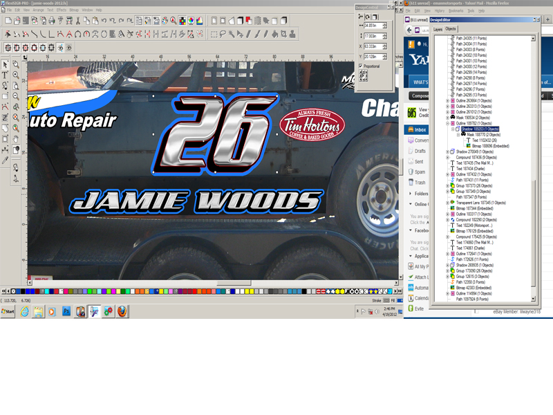

LittleSnakey
All you have to do is open the design editor, select the second tab on top, objects.
Then you can expand the items in your drawing.
pick it and it will highlight in the design editor then you can expand select the shadow and change the color of that.
Hope this helps
