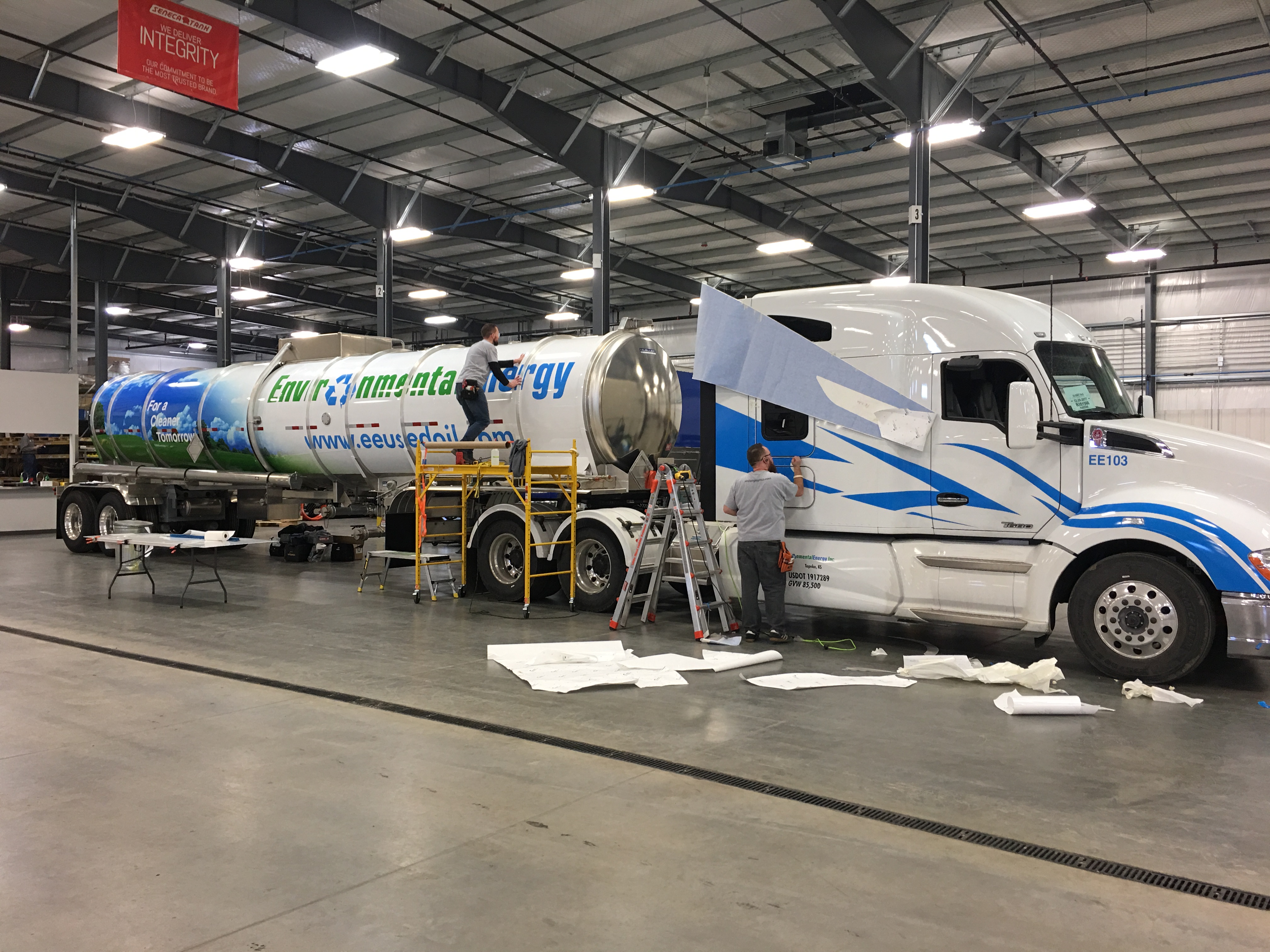

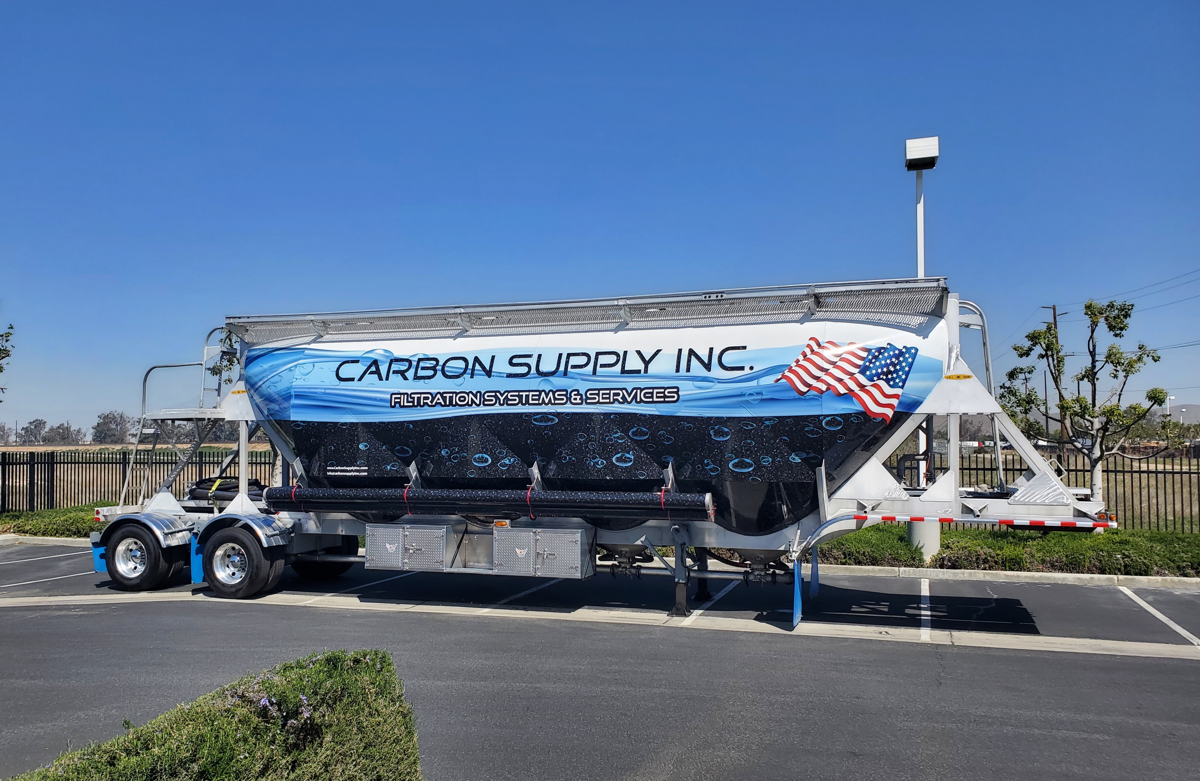

Here's a few ideas: use knifeless tape to cut the tough seams, and overlay the lettering, after the tank is wrapped.
It will be easier than you think. Here's two of these we did. I thought they would be much harder, but once we broke it down, it wasn't bad at all.
Good luck!

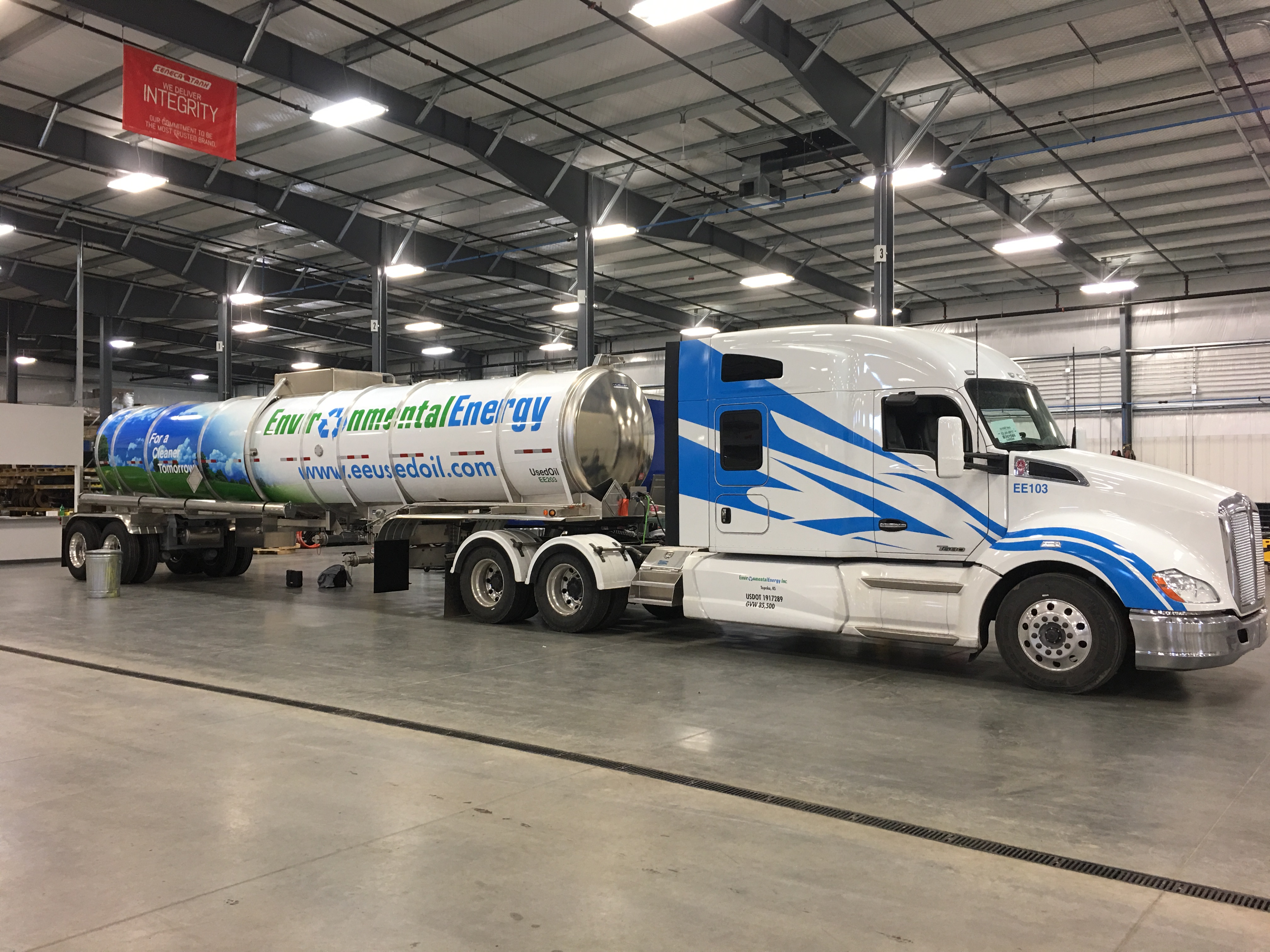

We have wrapped quite a few tankers over the years. This one was probably the most challenging. It's a caterpillar tanker and those ribs stick out 5" or 6". When we wrapped the ribs, we actually had to lower that piece of the vinyl down several inches and view it from the ground for each rib. Otherwise, visually it wouldn't line up with the panel next to it. Anyway, the curvature really isn't bad, you'll be fine if you have done other wraps before.
