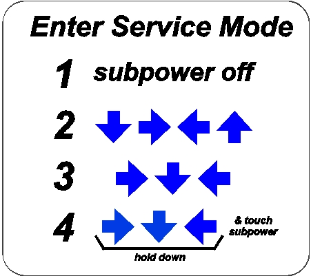

Jack Knight1979
Your timing is off. If you get the protected error, your doing it right, but at the wrong speed. The key sequence should be a fluid motion. The process should take about three to four seconds.
