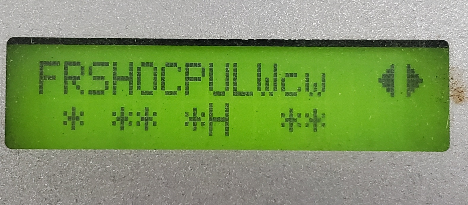

I've changed the 15 pin cable-card, and the sensor as well. I did a sensor check in service mode and Linear encoder check and linear calibration and no errors or fails came up. I took a pic of the sensor check display.

I've cleaned everything with alcohol. Looking at the sensor check pic it looks like the interupter is not getting any power. I performed a sensor check with pinch rollers up and down and took pics of the display and there is no * for the pinch roller sensor. I'm stumped.
If it's a new sensor and it still doesn't read, I'd say the board it plugs into is fried.
