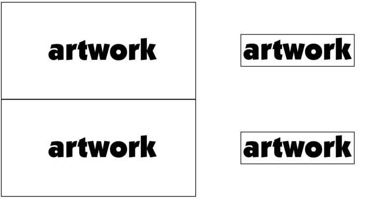

don't know VW, I use a different RIP, the concept is - make your file the size of the image, choose the distance between repeats - or print the same in a row, once the row is printed, manually advance the media and print the next row. Little illustration of what I'm talking about:
attachment.php
