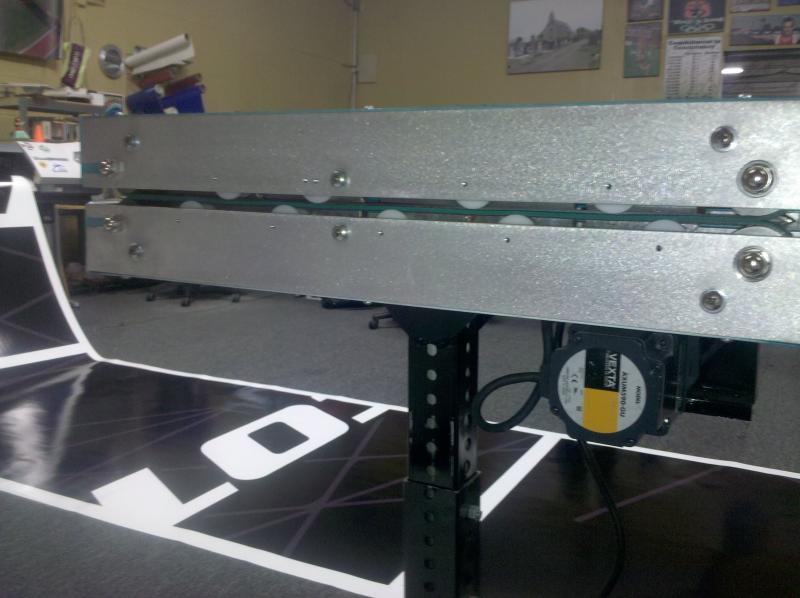

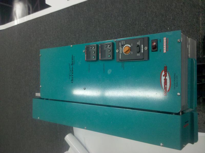

we have some kind of neat contraption that "melts" a seem into the banners with some pressurized heat wheels. We also use to sub out our banners for heeming but we do so many banners that it made sense to get this thing. I don't have a picture hand as of now but I might be able to get one tonight at work.
sdcali619
It could be that, but I havea feeling we have one of those hot air seelers as well and this is something different. Here are some pics for everyone.
