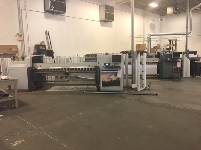

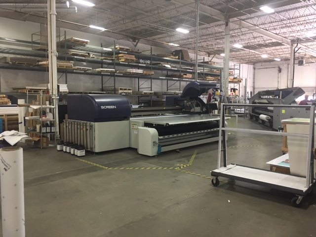

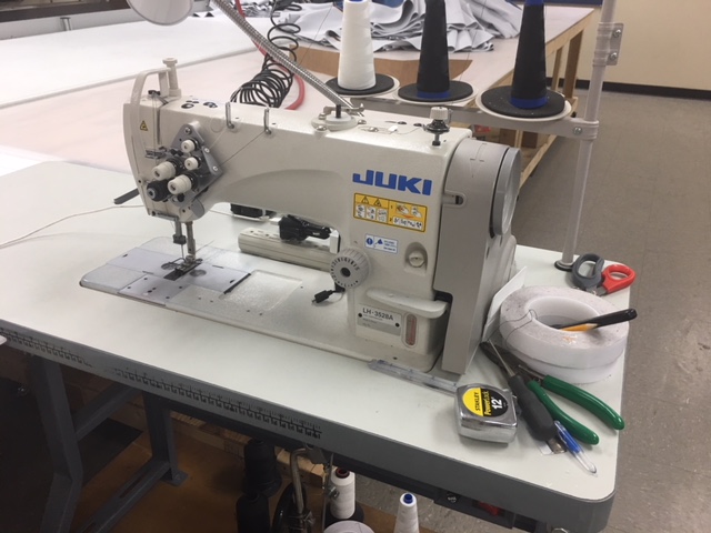

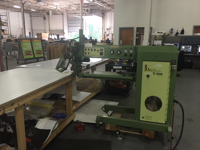

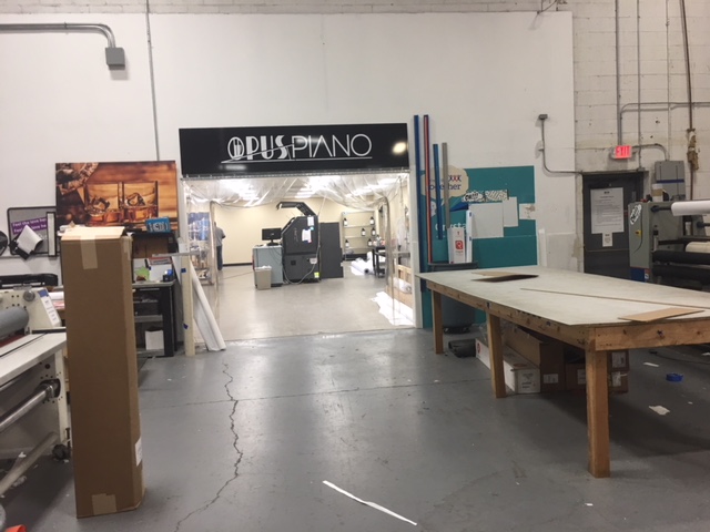

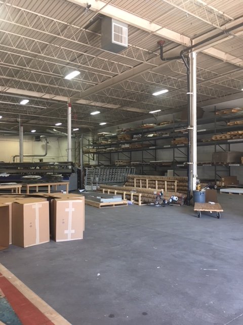

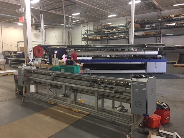

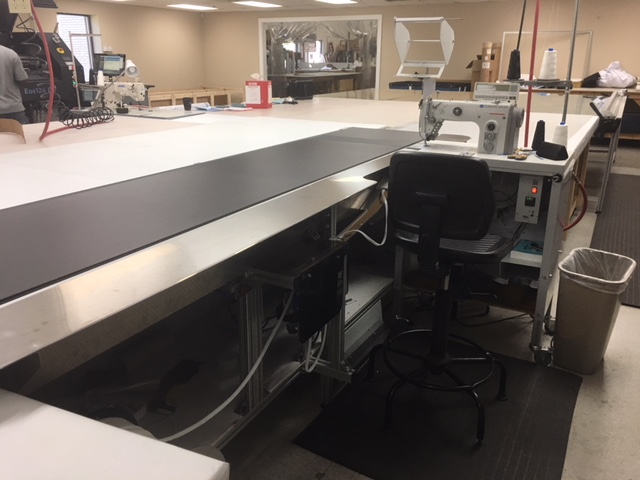

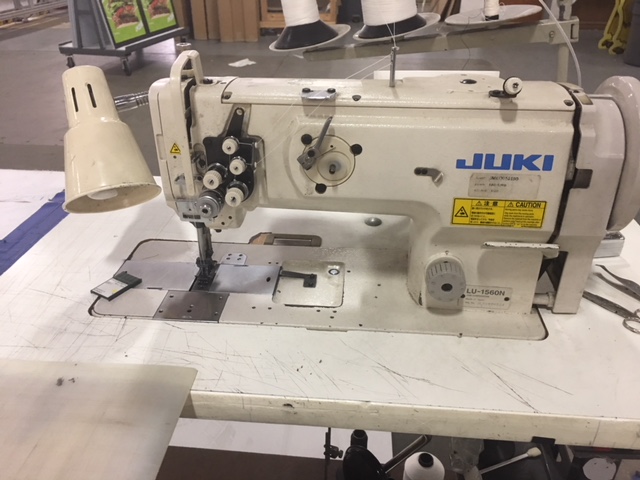

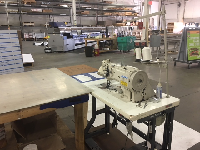

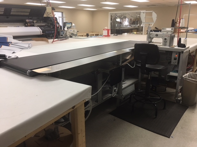

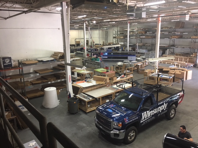

We have an Impulsa with the 10 foot automated belt mainly used for our Dye sub division for Silicon edge graphics (TFD's). The Jukis are used for Banner and we use our for hemming high volume runs as it is way faster than sewing. All serve there own purpose. The Juki 1560 pictured is the one I would suggest for the most versatile use. The Juki 3528 is very nice also but not as industrial. Yes, Impulsa is expensive, I think ours was about $40K with all bells and whistles. Jukis about $3,500 all well worth the investment.
Awesome. Please send me one, along with the table and the building. I could use all of it. Thanks! xD
