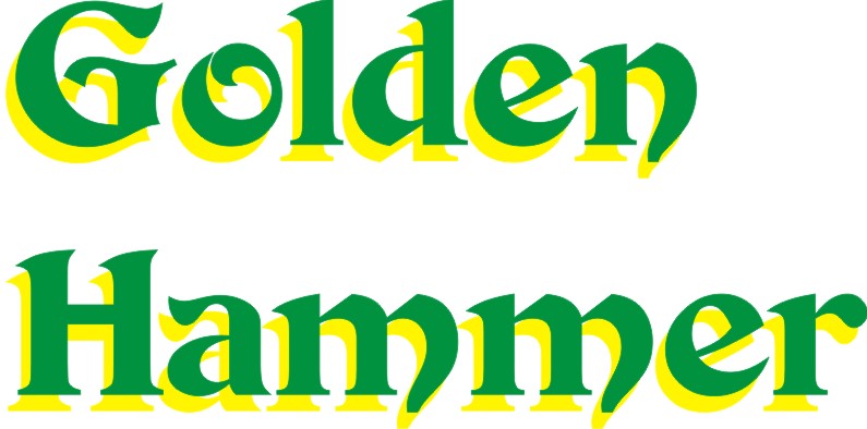

IAM SURE.......that can achieved in FLEXI.... you just dont know how......i can do that in COREL/ILLY ART & LETTERS.... and many other sign prgrams. 5 minute in corel......most of that was looking for a font)))

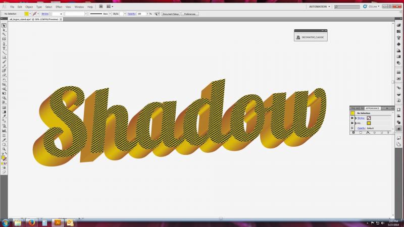

I'm going to take the plunge and get it. I do most of my work in flexi, but I have been trying to force myself to learn Illustrator, and it seems like every time I end up frustrated. But for those that may stumble across this thread and want to know how to do this in Illustrator... after some trial and error I got this:
View attachment Sellers Shade.pdf
Basically, you have to duplicate your text and create an outline by offsetting the path. Then duplicate the offset path layer, and go to 3D extrude. From there, it is pure trial and error. I set the perspective to 0 and the extrude to 1 and -1. Then increase the extrude depth and play with the shading controls at the bottom, and somehow you may eventually get something like I got. Haha.

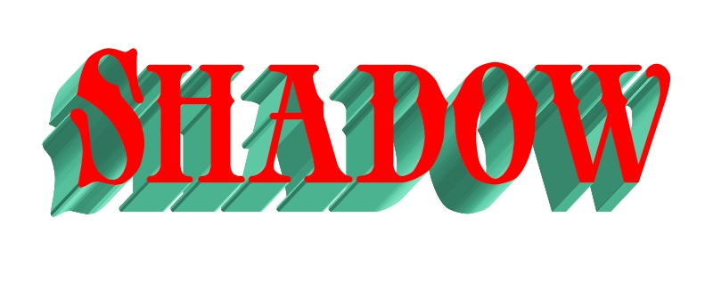

Corel, less than 2 minutes.
Create the text.
Use the Extrusion tool to create the basic solid color shadow then use the Extrusion Light Source dialog to position a couple of light sources.. You could tune this forever, I was trying for quick and dirty.

That is exactly what I am looking for! My trial version of Corel is downloading now....

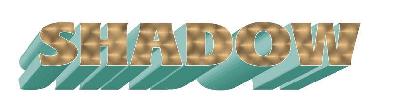

This was done in Flexi 10.5 with Alien Skin Eye Candy 7, took about 1 minute.
That looks great! Just a couple of questions... I downloaded the trial version of the Alien Skin Eye Candy a few months ago and it seemed to work great with Adobe, but I could never get it to work in Flexi. How are you making that happen? Is the engine turned gold you used also from Alien Skin?

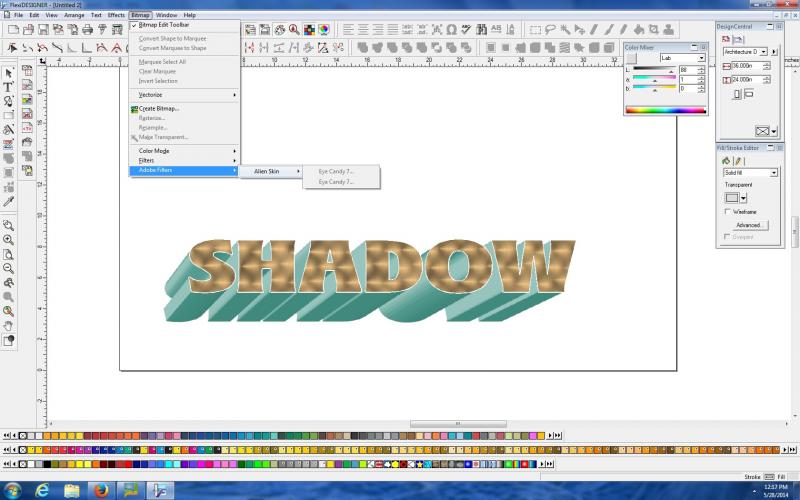

Thanks.
When installing Alien Skin it needs to go in the program files/sai/adobe plug in
If installed correctly it will be under the bitmap menu then down to adobe filters
Yes the engine turn and shadow are both from alien skin.
