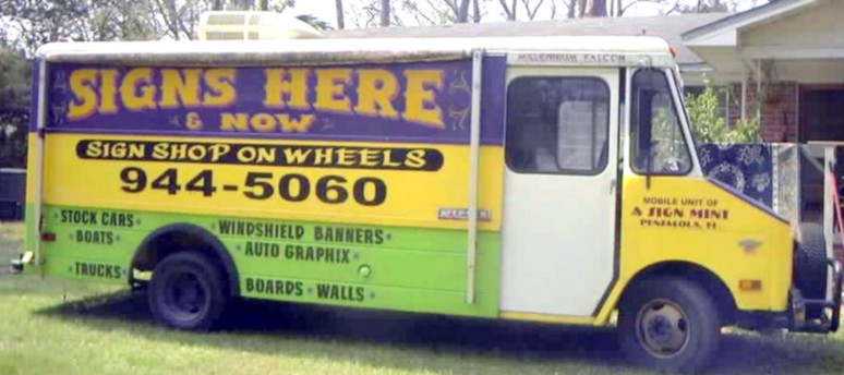

wow..................how crazy can ya get???since I HAD A MOBILE SIGN SHOP with a plotter set up in ..........a PNC-1100 ROLAND, 24"...........the need for it not to take shocking hits........can be resolved simple by getting 2 12" X 12" pieces of 1" seat foam rubber......set one under each end WHILE YOU ARE MOVING...... and also you need to put a bungie strap on it WHILE YOU ARE MOVING to keep it from sliding around on turns and hard brakings))))

Yea, thats a wild one. I'll bet you got some clients in that.
I got a different niche. My jobs are all prearranged. I got no signs whatever, except occasional magnets.
