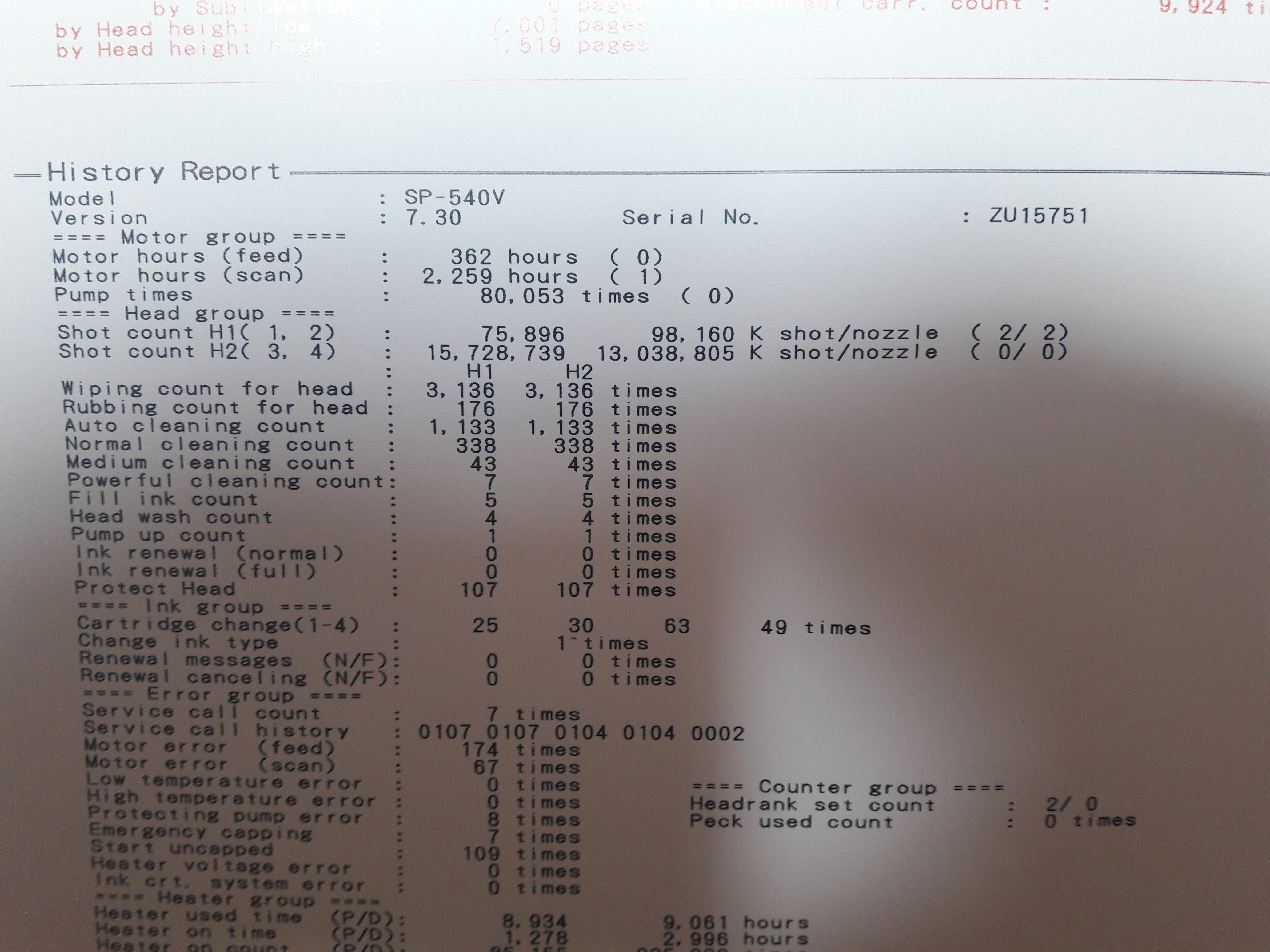

Hi Guys! It may be a dum question but its free to ask :) I did a history report on my roland sp540v and i can't figure it out how to count the drops. For example the head Nr 2: 15.728.739 K; Its that 15 billions drops then?? i attached a picture so you can see.
Thanks in advance! <3

Yes 15 billion which is about 2.5 times the expected life of the head. I would assume that the printer has had the head changed in the past but the head rank was not entered so the shot count never reset. There is no way that head lasted for 2.5 times the expected life.
