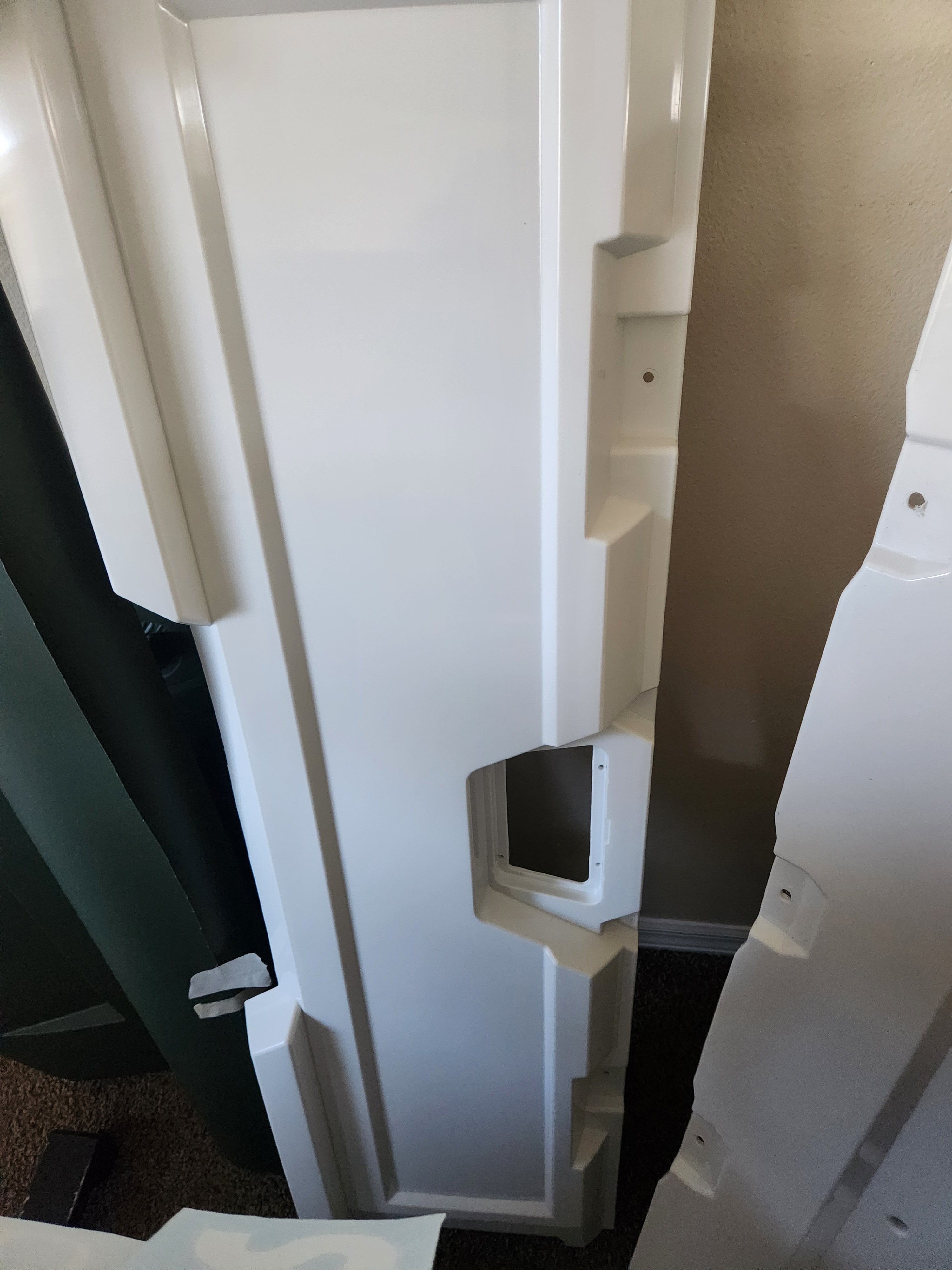

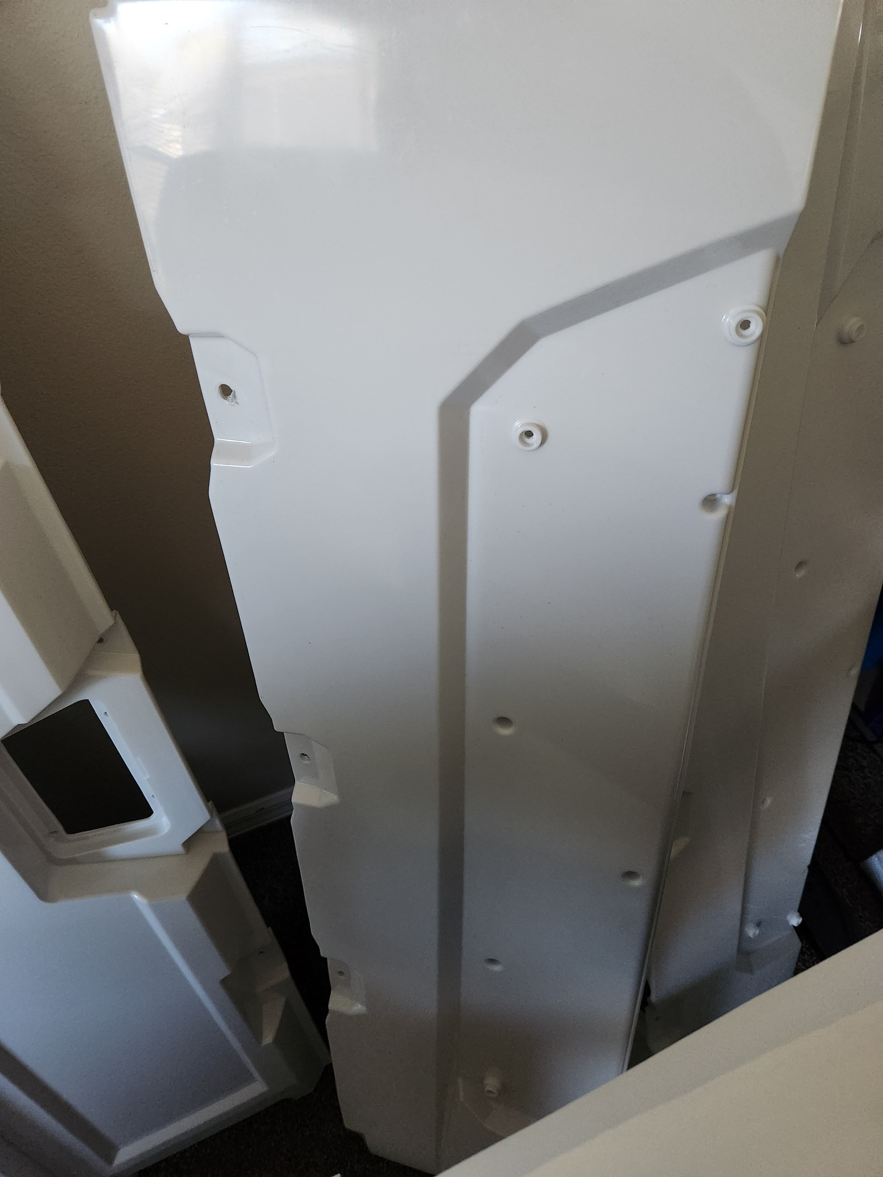

I can't find any videos on this type, plus it isn't even the same style that they sent me a picture of. It's a full coverage wrap, not just face decals so no white can be showing. Here's some pics of what I'm working with. I really do want to do it myself, im just struggling having had the flu for 2 weeks and way too much work on my plate. Even had to do a semi trailer today feeling like crap. This being sick is just zapping my confidence.

Eric H
That looks tough, definitely multiple pieces and inlays. If you're trying to do the panels in one piece they will never stay down. You can't just stretch everything into all of those corners and creases Templates aren't going to help. Knifeless tape is your friend. I know this isn't helpful but those pieces would probably be better painted.
SightLine
Agree with Eric. Too much going on and impossible to wrap those in one piece. Some of those parts are going to require inlays and seams. Do the inlays first. Like that first pic - the inner corner with the flat bottom above the rectangle hole, impossible to do that as one piece.

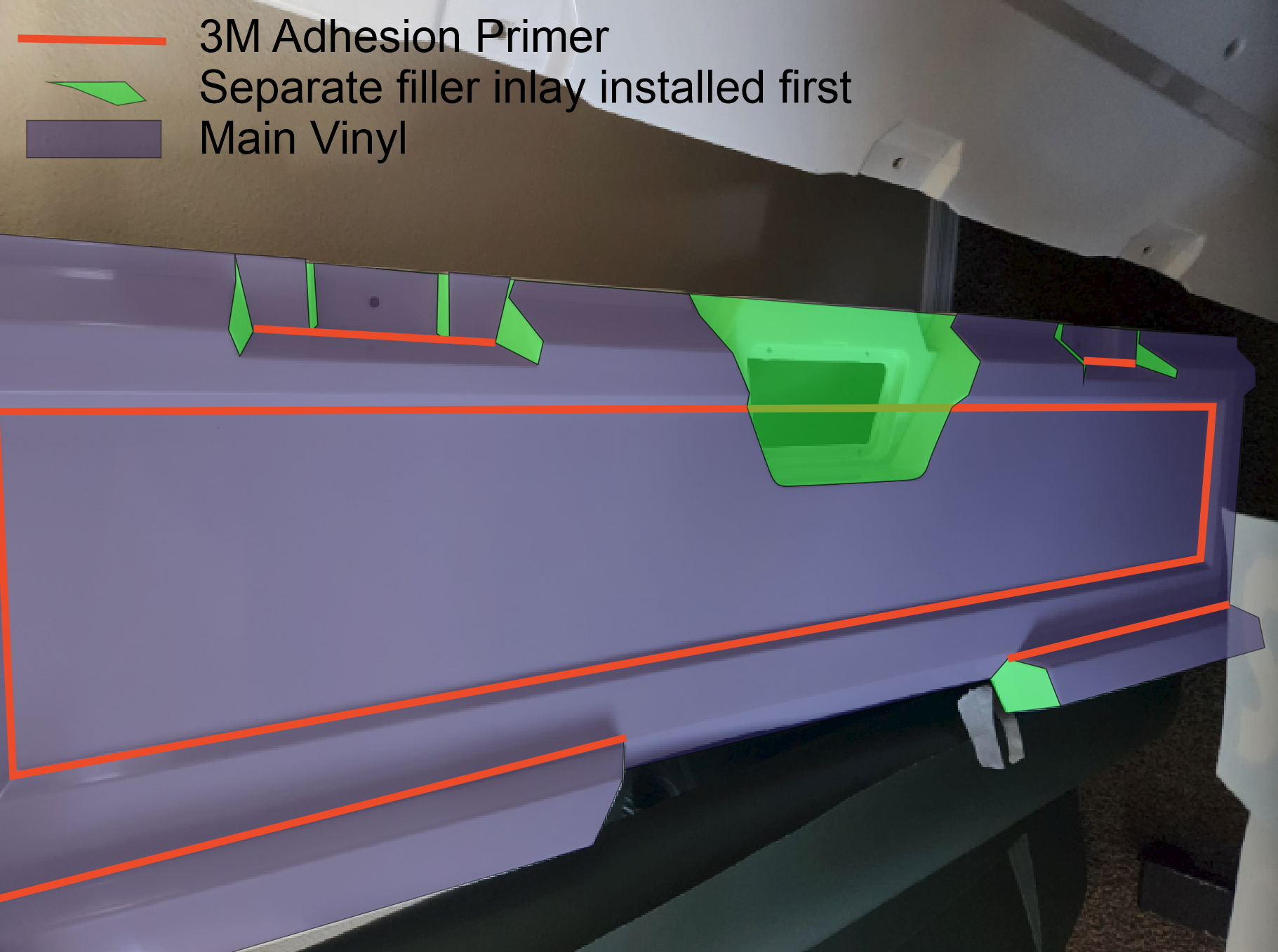

somcalmetim
Yep, no way those get wrapped properly without seams and inlays...even the bodylines on a Sprinter van will come back up if you just heat/stretch the inner bends and those panels you show have much sharper bends.
The guy in the ATV wrap video is doing it pretty well but I think I could get away doing his panels with a couple less seams on the outer bends...I wouldn't pay much mind to someone who tells you how well their installer could do it.
I would attack it something like this...if it is a brand new high dollar machine I would use knifeless tape like guy in video but if its already been in the bush or I have to sand panels anyway you can usually get away with just lightly hand trimming the edges on the panel...
