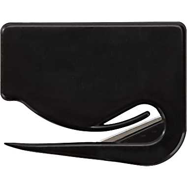

One last, hopefully helpful tip. When we get a wrap we first back out as much as we can with the reverse switch on the laminator. Then we use a hem cutter, I'm not sure if it called that, but it is used to cut the stitching when sewing. It looks like a small mettle serpents tongue with one side longer than the other. Both sides are blunt with the cutting surface where they come together in the middle. It is a little time consuming but better than hacking up a roll.
Wouldnt one of those envelope openers work better?

Suz
seam ripper?

Yep, we have those too, from now on it's the only thing going near the laminator. Stupidly I thought that just telling the employee three or four times to be VERY careful with the rollers and DON'T cut near them would have been enough, but... And it's masked vinyl, not that super expensive material, so what's the matter if they roll out a couple extra feet... Well, lesson learned, the laminator works well still though, no signs of problems with the cut but I'm prepared for the worst.
