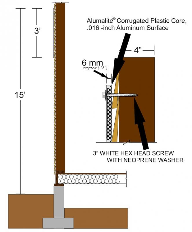

We ran into this silliness some time ago as well. I just drew something up in Corel and sent it to an architect to have him give his seal.

The town is just covering their @#$ to make sure that signs are properly mounted, and not stuck up with duct tape and liquid nails. I would call the town planning and zoning and see if they have an alternate way of allowing the sign. You will have to supply a drawing of the proposed way of installing, and they will send someone out to check to make sure its installed the way you proposed.
