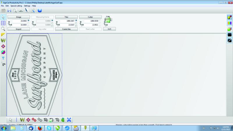

Well, you had me all excited with that default setting. But now it's just cutting upside down, but still at 24" width instead of length. Since my print area is only over 22" wide, I want to rotate it to cut one piece.
I can't believe how complicated this is.
:banghead:
Here's the way my screen looks. What the heck am I missing?
