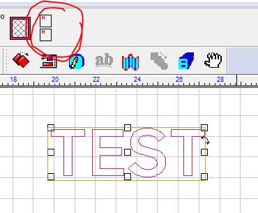

Any idea what these two N with square around them are? Thats the only difference i can figure out that is making the right file to go to onyx to recognize its a flex cut.
