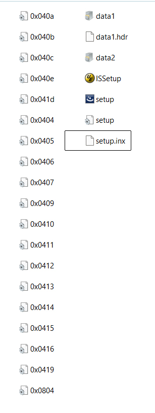

The "Secabo T60II" driver is only included in SignLab 11 and not in SignLab 10.
This problem is easily solved.
- Download and install the demo version of SignLab 11. After installation, you do not need to register or start the program.
- Go to "C:\CADlink\SignLab 11.0" and locate the files below, then copy and paste them into a folder on your PC's desktop.
You now have the SignLab 11 driver setup package. Start installation and check if you have everything.
- Uninstall SignLab 11 and install SignLab 10. Copy and paste the files into "C:\CADlink\SignLab 10.0."
- Start the installation to install the desired driver.
Good luck,
