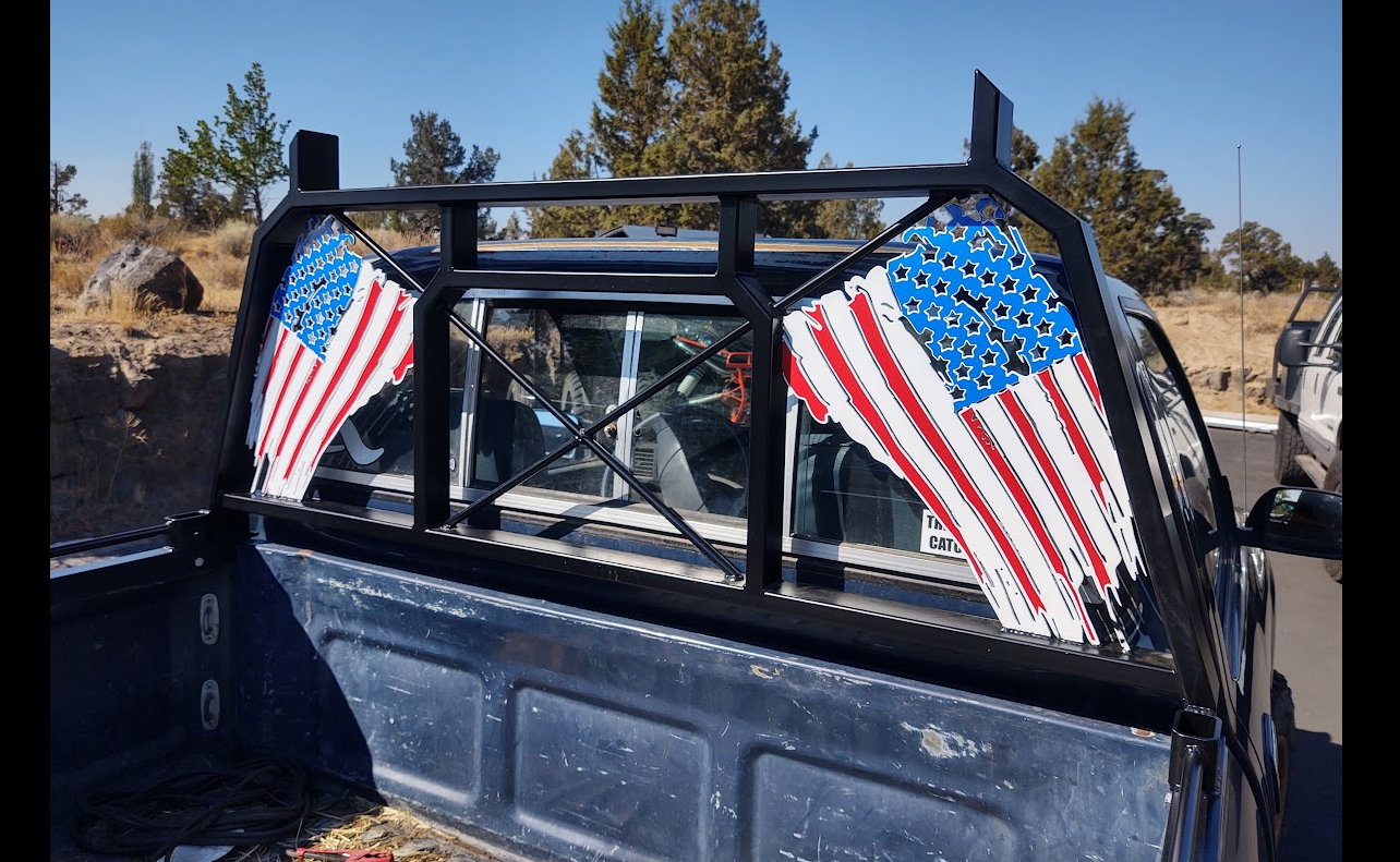

On another note, I designed and built a headache rack for my pickup. I cut the steel on my plaz and had a sign shop cut and install the vinyl, which I designed using the same software, and they cut it without issue. As you can see, the size of the vinyl on this was critical.
