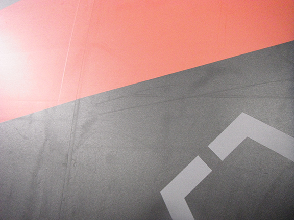

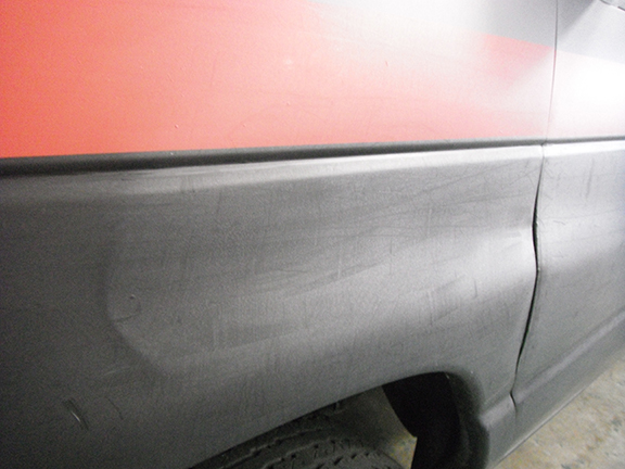

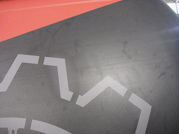

I understand that there will be inherent problems printing UV ink on wrap material and laminating without any heat. My issue is this. i am using a new brand of Avery Wrap material that is "specifically designed for UV printers". We are trying to convert an E-350 into an A-Team van. The install went great with only a few issues. A little overstretching on some compound curves made the ink crack. Surprise right... The driver side has a ghosted white appearance and shows some of my squeegee marks. The passinger side turned out great. We were able to take advantage of a few warm days in December and the sun cooked out the slivering so we are good to go. I am now trying to fix the driver side and using lots of heat and squeegees to smooth out the marks. any suggestions?

I have never heard of UV ink for wraps. Are you sure it was properly outgassed before lamination?
Try a UV lamp? A torch can make things magically get better but can burn things quick too.
WorldWideWebb
Yes I am using torches. I am even trying MAP gas (making very sure not to overdo it). UV can work for wraps but solvent printing and even latex is so much better. Unfortunately there is no outgassing to be had with UV ink. The lamps cure it instantly. I even waited the standard 24 before wrapping. Thanks for the suggestions though!

Yes, with those special considerations listed by Avery for UV inks (heat assist), it can be laminated to UV inks.
That doesn't mean you should then try to wrap a vehicle with it.
UV cured inks (at this point in time) are not meant to be stretched (as on a vehicle curve) for the specific reason you stated..."...some compound curves made the ink crack."
