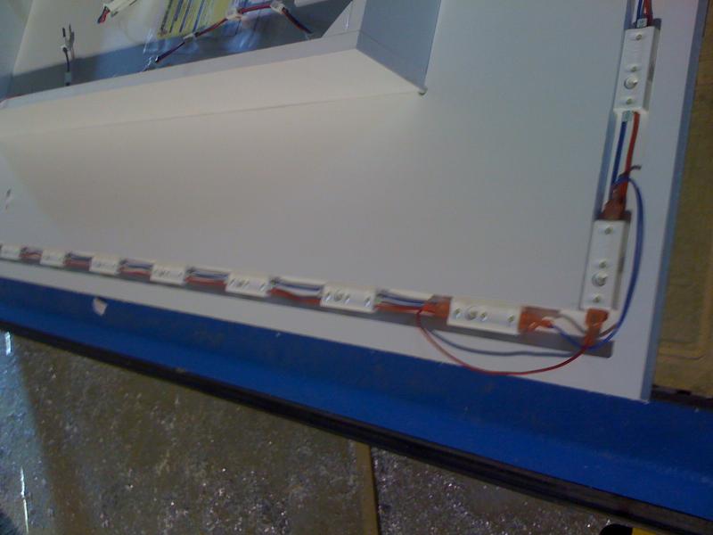

pic1) roughly a 46"x 48" 1/2" pvc. Routered 3/4"w x .300" d channel for the LEDs, and roughly 1/2"w x 1/4" d channel for the 3-1/2" strips of pvc. Used pvc glue on the 3-1/2" and set them in the channel. Measured out the LEDs for the other channel and set them in place.

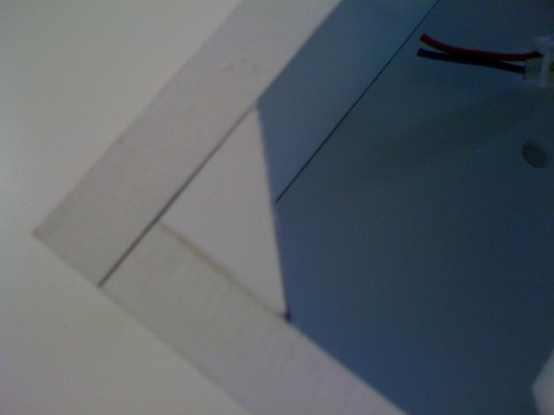

pic2) Cut pieces to reinforce the upper corners. Pvc glued into place

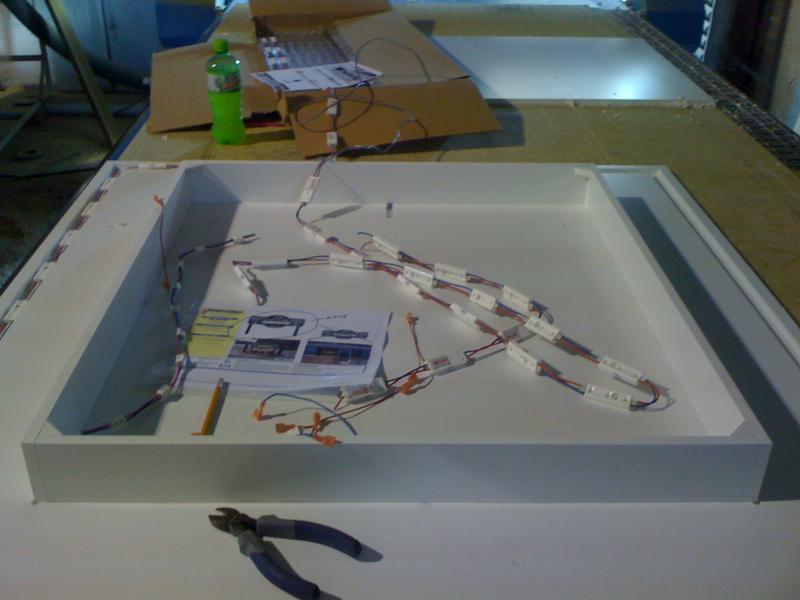

pic 3) Stuck LEDs into place and wired

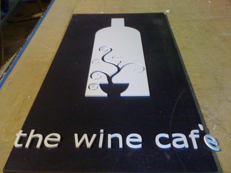

Pic 5) the 1/4" white pvc logo and letters that will be put on after the viynl is installed

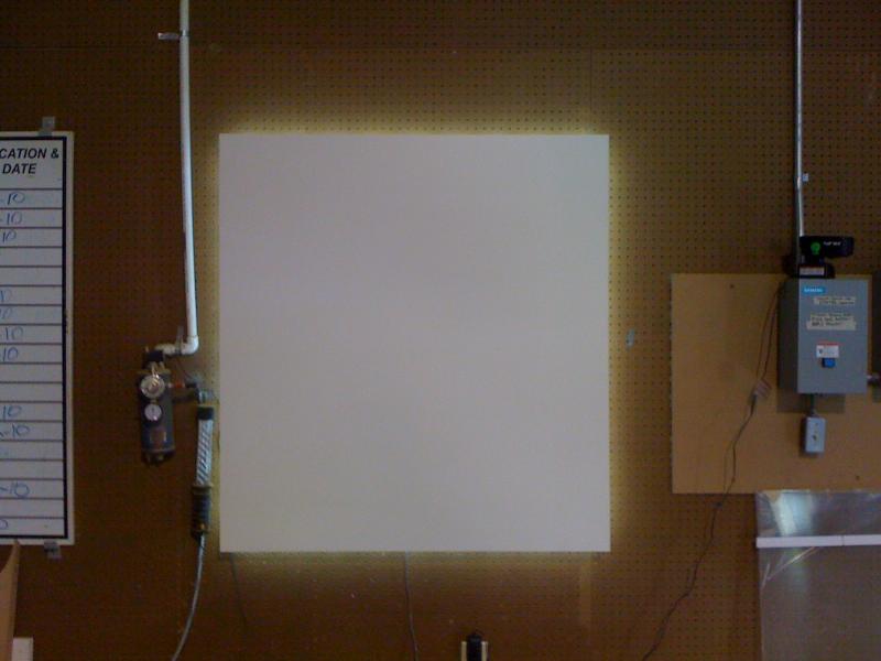

pic 6) may be hard to see, but the sign hang on my wall, lit. Nice to power the whole thing off a small plug-in transformer.
