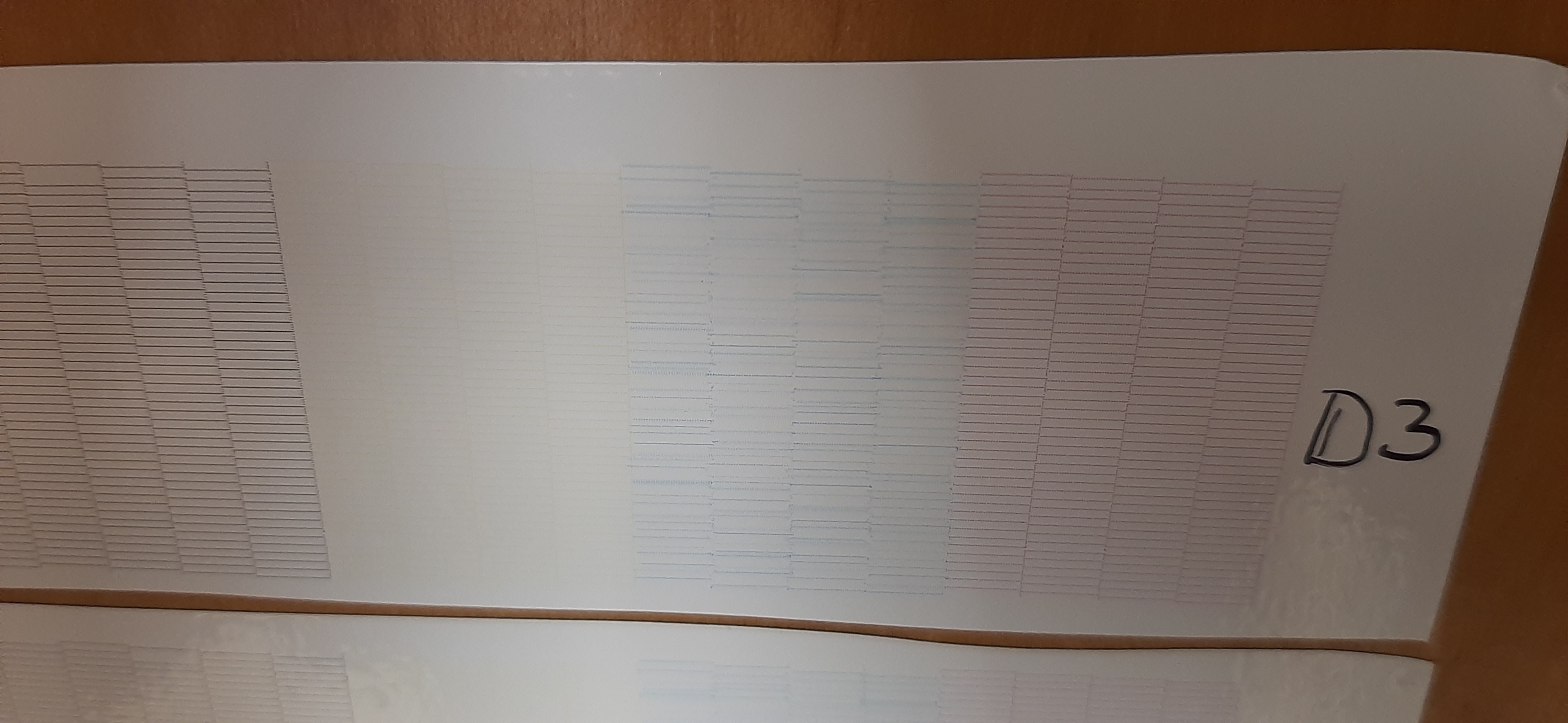

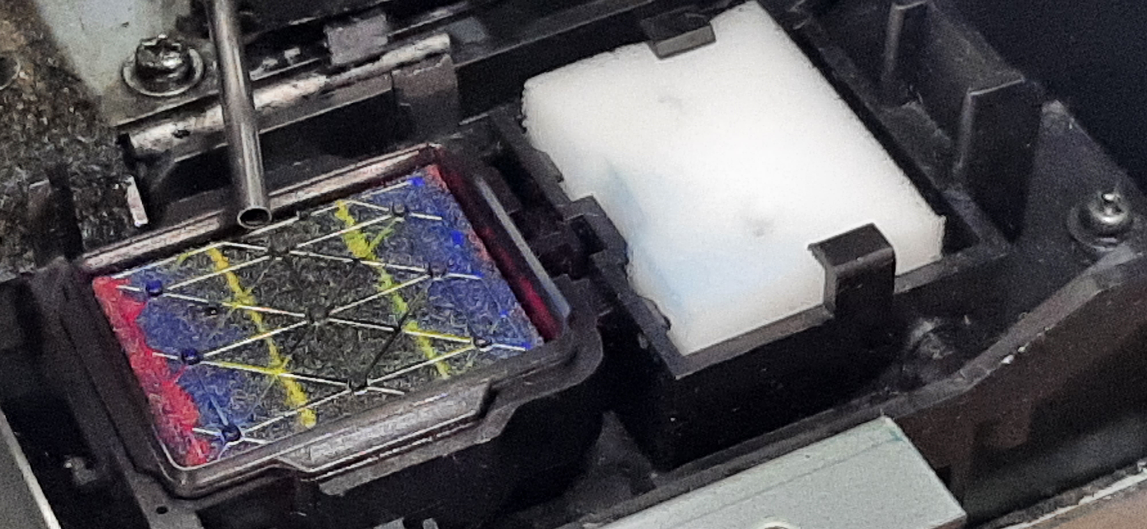

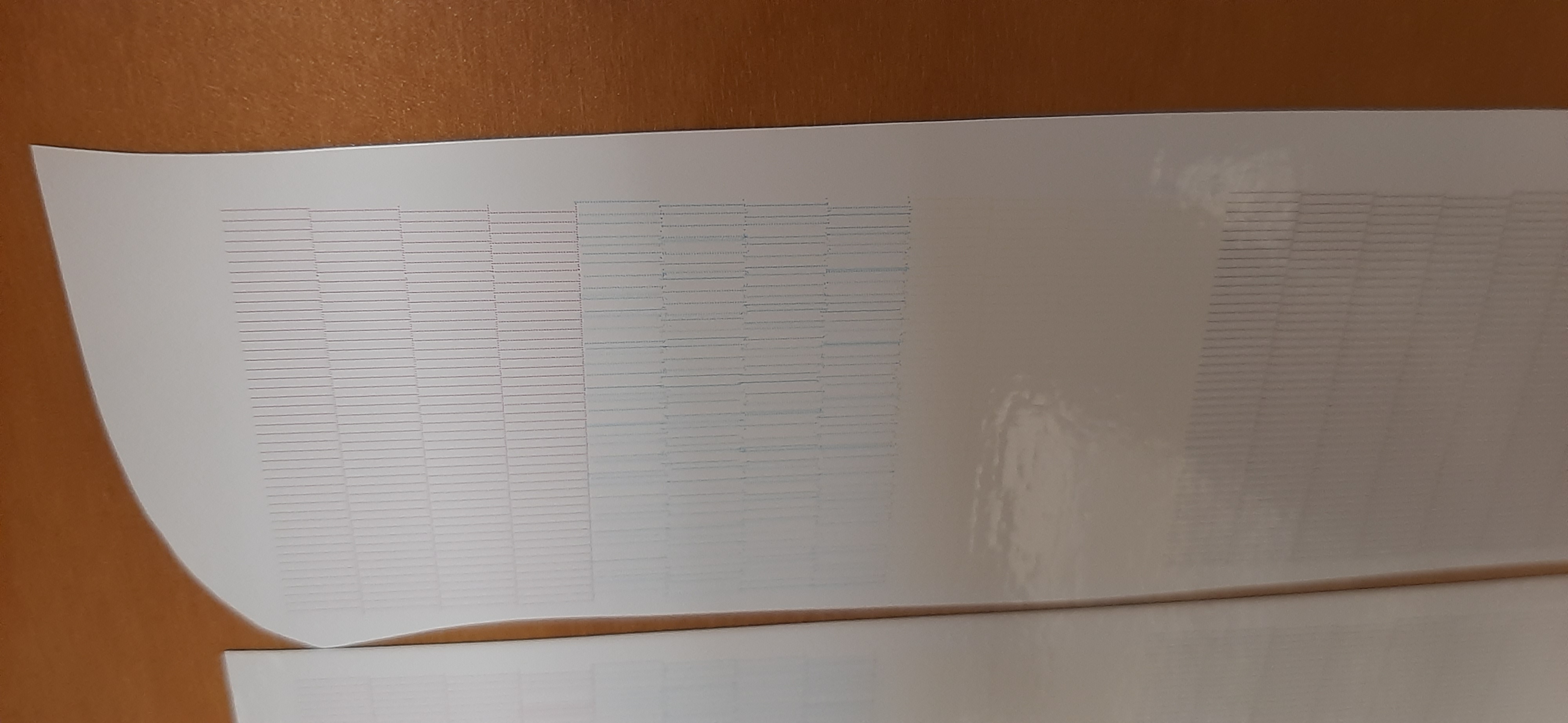

About a week ago, our cyan just randomly started having poor quality (see attached file). It even sprays cyan "mist" over the material guides and you can see it on the white pad in the attached picture. I had just replaced the white pad so it doesn't look that bad in the picture (it is after about 30 minutes of printing).
I'm still running it but I have to do everything on 24 pass. It looks OKish (barely) but have to get this fixed obviously.

I've checked to make sure the blue "cap" is on the underside of the capping station....the one techs sometimes forgot to remove from the old and put on the new when they are replacing the capping station.
I've tried numerous hard washes.
I've checked to make sure the station is capping correctly on the ink head and I don't see any issues from what I can tell.

Hi, I've been through this before as well and unfortunately it seems like in the end it's probably a head replacement and yeah, sometimes they last forever and sometimes they don't. If you want to try it you can disconnect the ink line where it goes into the cartridge needle assembly and stick that into a bottle of cleaning solution (bonus if you warm the solution). Clamp all the other ink lines shut Hemostats, clips, etc) and then pull 3,4, 100 syringes full of liquid through the head. It might clear it up but whenever my heads have started misting like that I always end up having to replace them even after spending hours and hours trying different flushes.
I use boardeax in our JV150 and we had the same exact issue with cyan recently as well. I was even convinced at one point that it was the inks fault and tried OEM cyan. Wishing I had just replaced the head in the first place as it would have saved me a good 5+ hours trouble shooting.
Anyways, good luck! Head replacements are easy btw.
