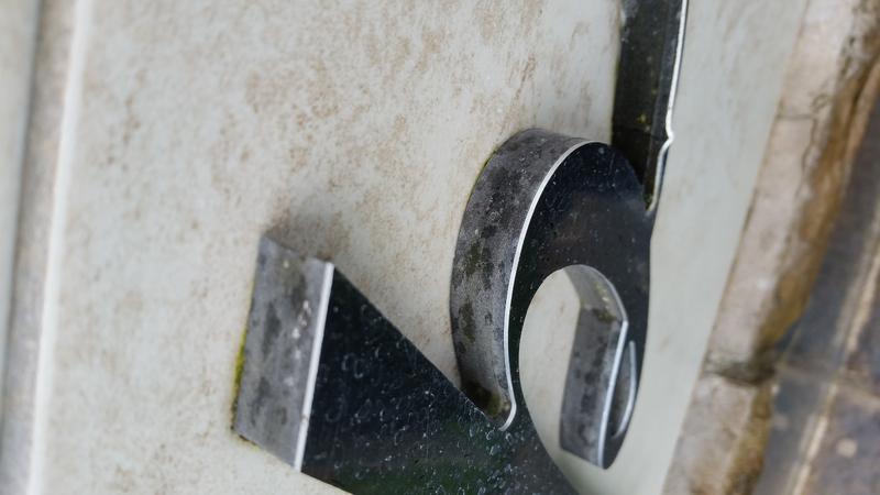

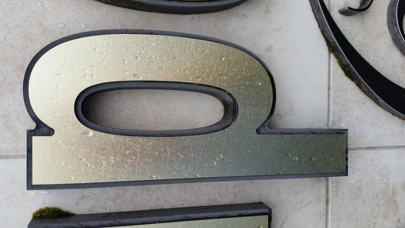

Hello,
I have this client that wants to replicated what is currently existing but with new colored faces. It seems that he has 1" Black Sintra (possibly foam) that has .040 Aluminum laminated to the front of the cut letters. My question is how do I go about A.) laminating the aluminum to the sintra, do i do them once the letters are cut out of each material or should I laminate the 4'x8' sheets together before cutting? B.) What would be a good bonding agent for the sheets?
I have attached some photos for reference.

I do this all the time - I use mactac IB2107 laminating sheets (they are like 17"x22" sheets) but any permanent double sided adhesive should do (some come in quite large rolls)
mount before routing.
I usually mask, then route, so I can spray the edges after routing to get rid of the 'metal laminate' shiny edge
edit: that 'p' looks odd, possibly routed face-up, routed 1/4" deep then cut through
