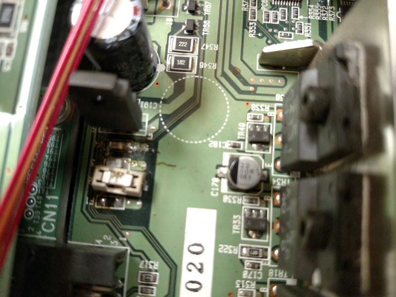

FrankW
There is one fuse for every group on the head board (near the connectors). Try to measure if the middle one is broken. Unfortunately the fuses are solded, so you need a soldering iron to replace it.
Solventinkjet
DIY Printer Fixing Guide
There is a fuse on the head board that you most likely blew and the fact that you smelled smoke indicates that the transistors may have fried and/or there is a short somewhere else in the machine that caused the smell. I'd have someone take a look at your head board to see if they can repair it. If you have soldering skills, you should be able to put a new fuse on yourself.
ratm92231
Apparently the fuses look bad, could someone give me an opinion? Thanks

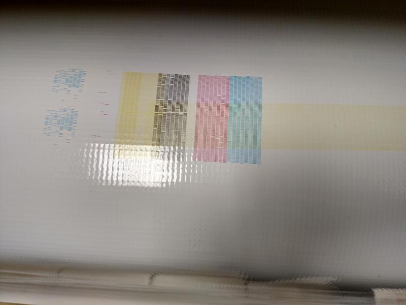

ratm92231
OK, I just repaired the board and it works. So everything is back to normal, but the yellow ink keeps printing on top of the other colors when I do test prints. Do you guys know what's the problem? I've already changed the carriage board but not the ribbons.

VanderJ,
Here's the picture of how it comes out, i'll see if the transistors are what's wrong with it. Any other options?
Dampers, cap-tops and wipers are in good condition, but I don't know why does it does that. I'll check transistors then i'll swap the heads to see if it does it with other color. Any other options? Thanks
