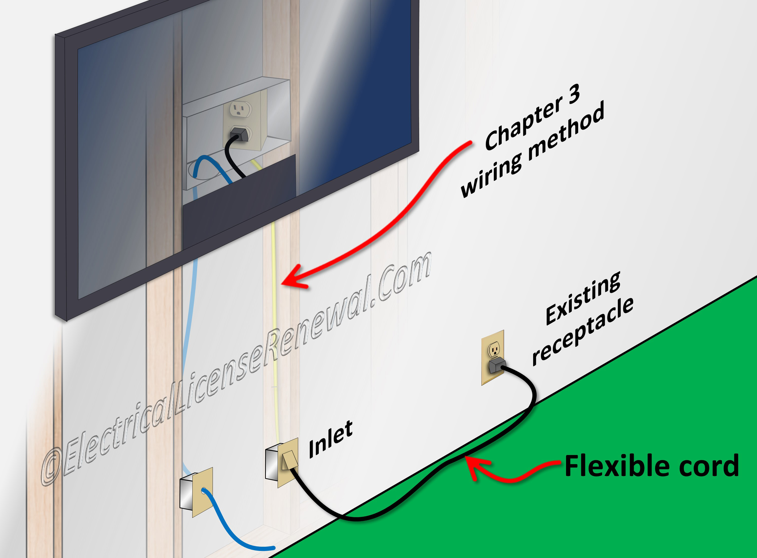

I'm no electrician but have watched some Youtube. This is portable cable and seems like it would violate the NEC if it's used as the homerun or hardwired. Looks like it can be used to plug a sign into an outlet but the NEC 400.7 specifically states portable signs so that might not even be allowed then passing through a wall with portable cable is a huge no no unless there's some weird provision for this application. As far as putting in conduit, doubt that is allowed either due heat and if it is you would likely lose amperage capacity. You'd have to check cavity fill and could possibly get it to work with oversized EMT if the NEC allows it. You can't strip the outer jacket but if you could, the conductors would likely not be marked which is also not allowed so that isn't a possible work around either. It seems very hack to me with lots of questionable issues, THHN in emt and transition to flex or liquid tight as needed is the right way IMO.

Found this, not sure if it helps with your question. Looks like the run in the wall is romex so you'd think that if going through a wall was up to code, that cable would just run from the TV down to the outlet with no junction boxes to transition.

Even if you could argue for them being luminaires, you still cant pass that cable through a wall AFAIK. You'd have to properly wire to a junction box that is on the other side of the wall (side where sign is mounted) and then hook into that like you do with exterior flood lighting that comes with a whip.
