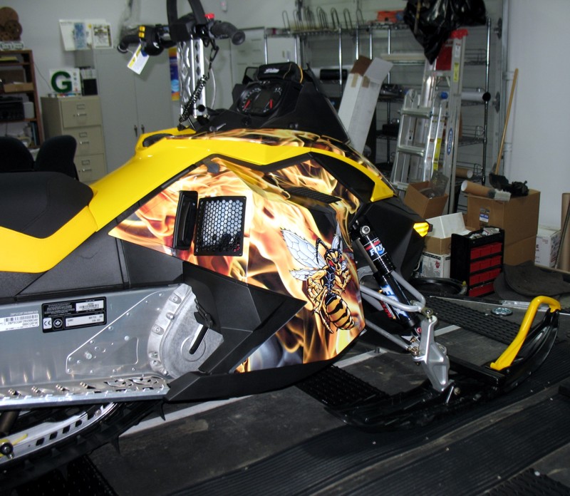

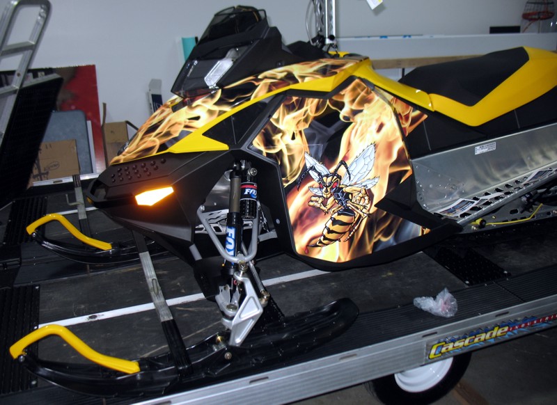

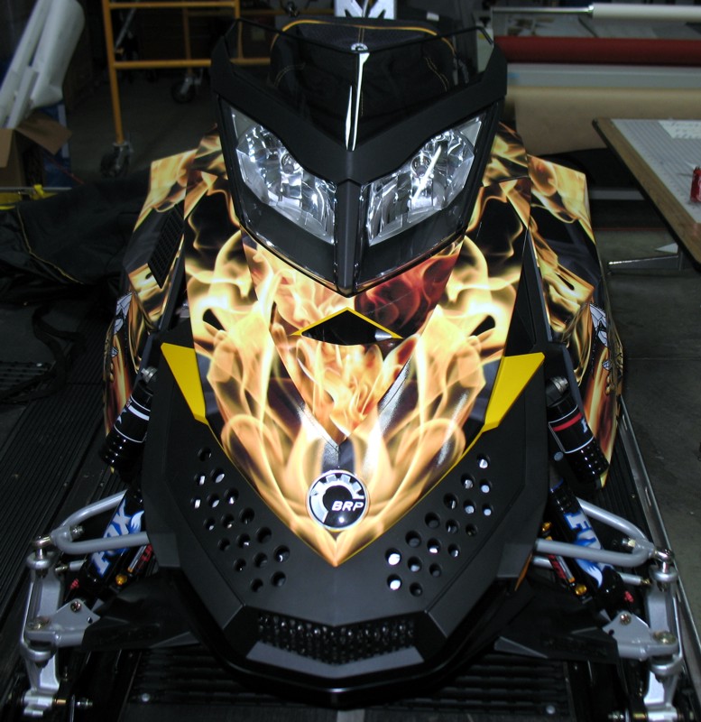

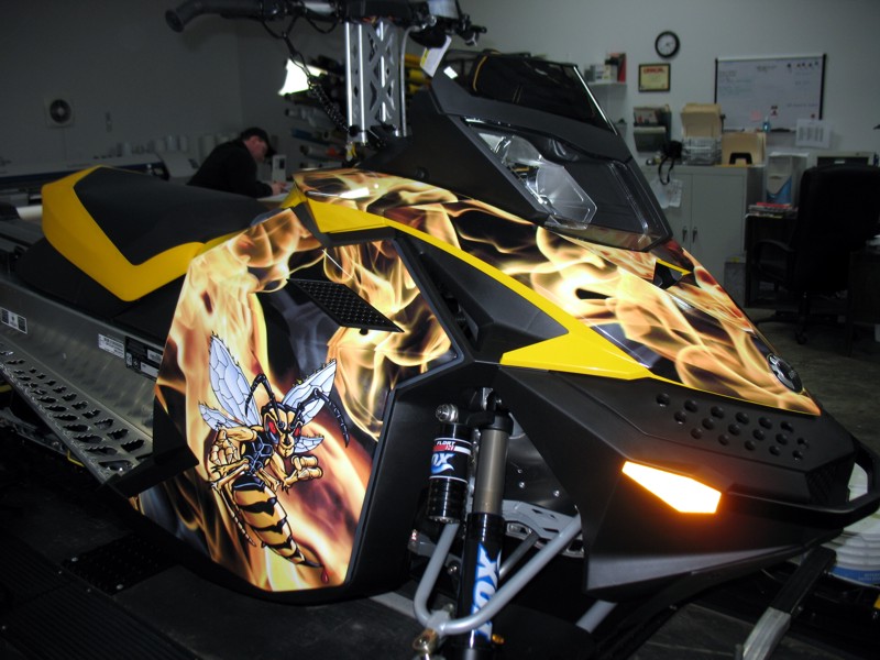

Here's our only sled wrap to date. We used wide paper and traced over the panels to make the templates. Honestly, you really can't charge enough for these things. We've had several ask after seeing this one, but this one is the only one so far! It is supposedly gonna show up in some sled-head magazine. Still, this was a cool project and it was a brand-new sled...never even been started yet.

Well on ours (since first one) we of course had a lot of time into it. We had, in reality, about 10 hrs of design and installation. Installation on this was 4 hrs by itself. We low-balled the price (just out of sheer ignorance) but ended up getting about $700 for it...shoulda been about 50% more! This one was a PITA with all the compound sharp angles going on there.
