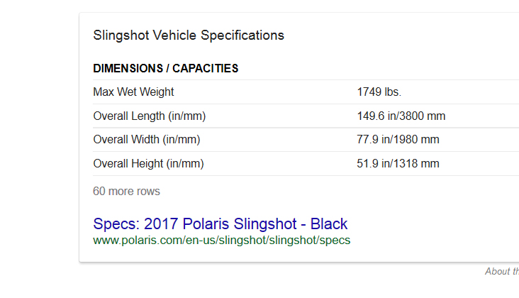

Has anyone ever wrapped a Polaris sling shot ? I am trying to figure how much material it'll take. Also get an idea how much people charged to do a wrap like this. He'd like a lot of the interior wrapped as well.

This might help you a little . i searched the specs on one .so this might give you an idea maybe..with width etc.Everyone will be different on cost install. I havent had the luck of doing one But if its a solid color i would be bewtween 500-700 ? i could be way off cause i dont have any info or vehicle to actually look at in person to measure for accurate measurements..Sorry i couldnt provide more help.
