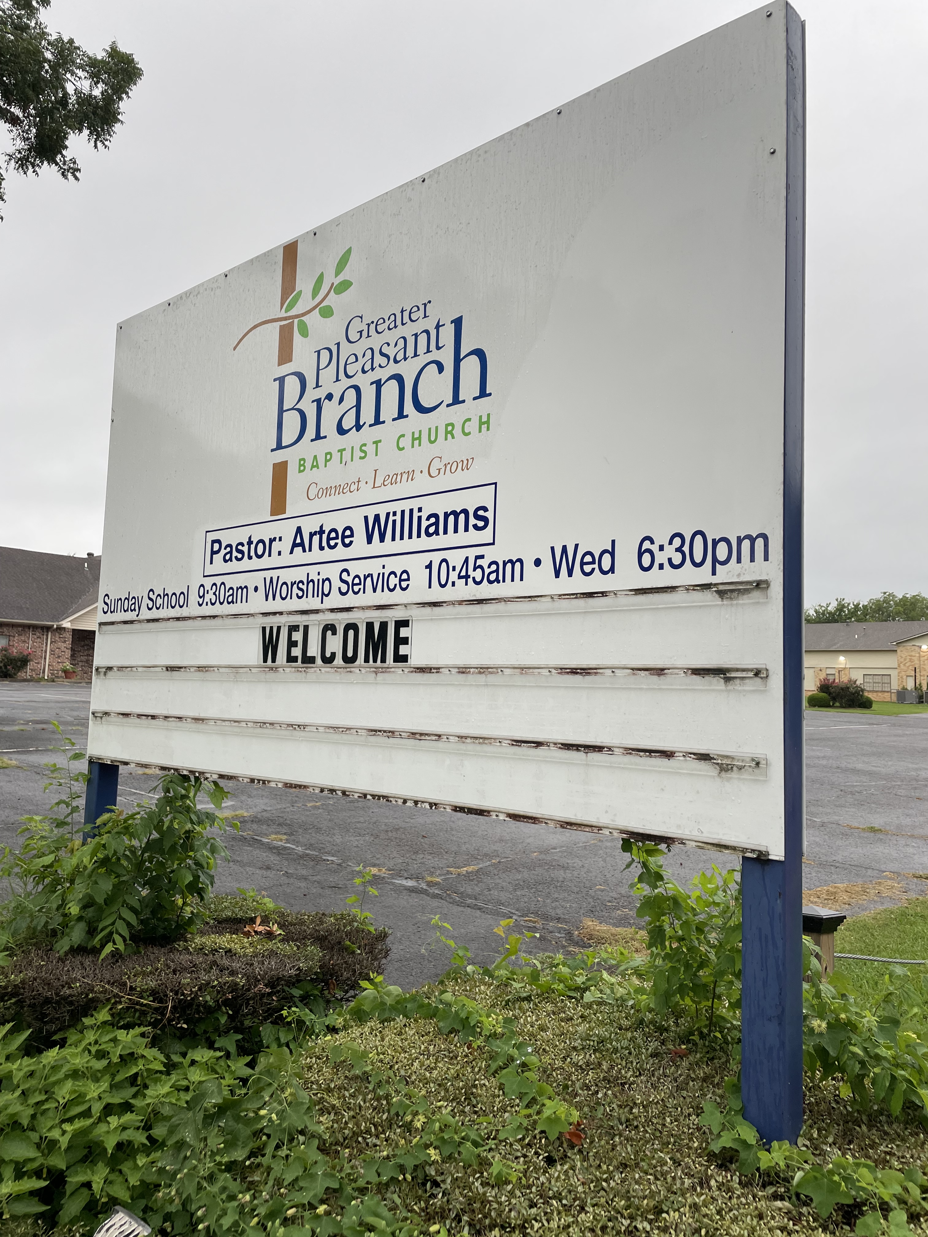

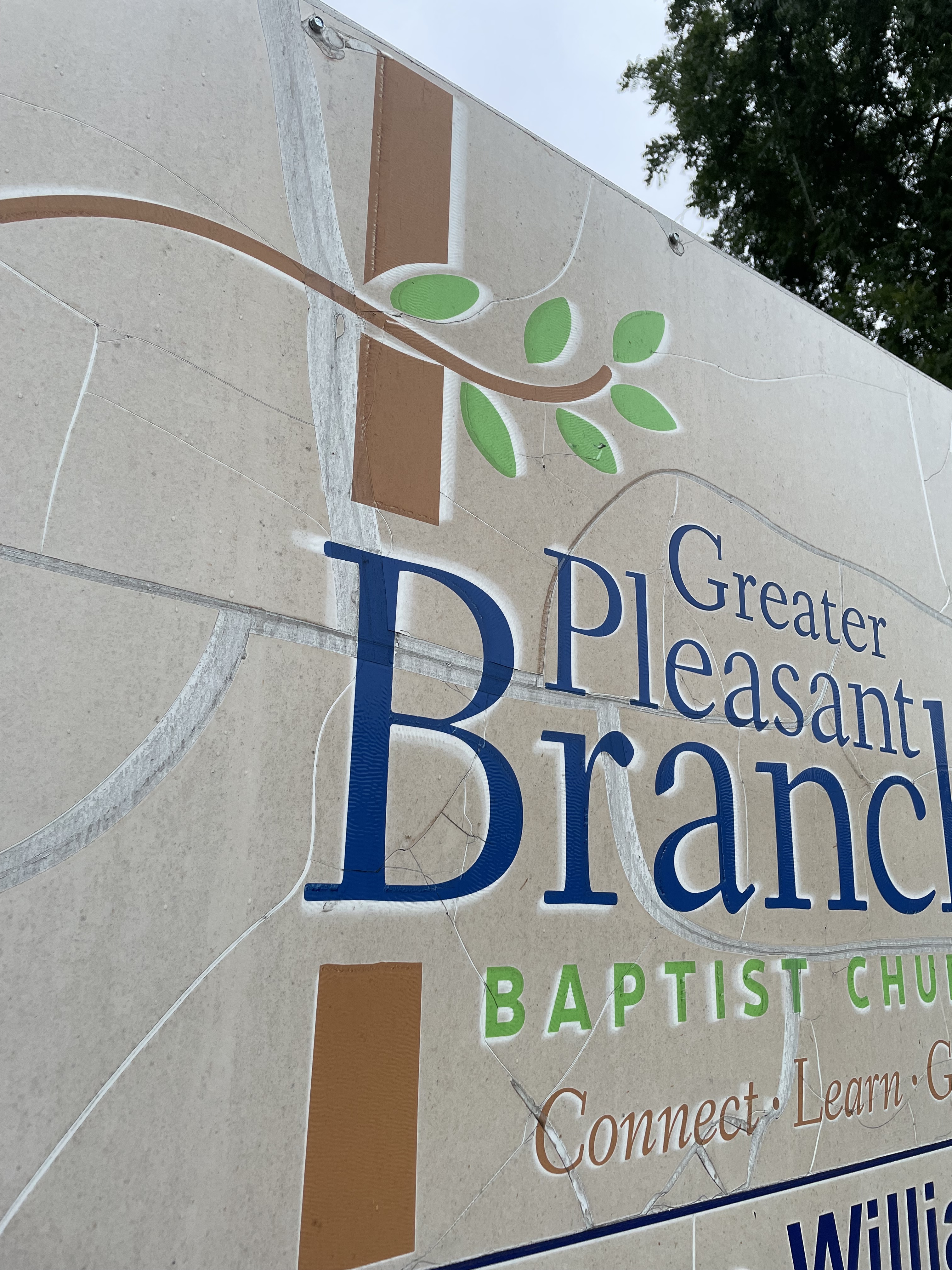

Funny enough, I'm redoing one side of a West facing sign that's from 2018, printed on ij35 that was wrapped around the edges. East face looks fine. It's actually one I've meant to share with that other thread, as even wilder than the 'texture' appearing after years, it looks like it has a drop shadow of burn in... The full face shot is the one they just want cleaned, the opposite side is the close up.
