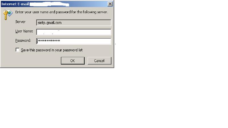

when you hit the SEND button in a new E-mail or press the SEND/RECEIVE refresh button you get the SMTP Authentication pop-up window and will not go away regardless of the number of times you press OK, CANCEL, or the X
so far all computers have been power cycled, router power cycled and did a reset on, modem power cycled. HUB power cycled.
you can send E-mails fine through the Web interface and via Smartphones

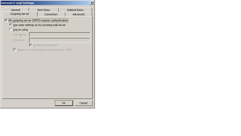

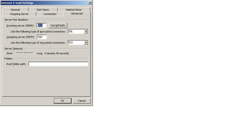

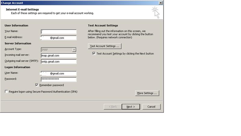

On the port I have tried SSL 465, TLS 587 and SSL 25

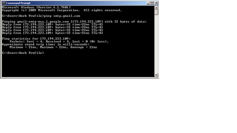

While im waiting on more info, if you have spare time, ping smtp.gmail.com from the computer with issue, and post the ip it comes back with, or do a search to see if its googles server.

Your settings are correct, for the record, 587 or 465 are the correct port, i use 587. 25 is the old unencrypted port which gmail doesnt use at all.
what did you get when you pinged smtp.gmail.com ?

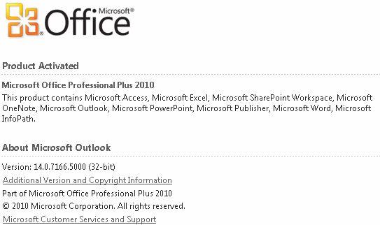

and What version of Microsoft Office Outlook is it ? Ms Office 2003 ? 2007 ? 20010 etc etc
-- edit -- i just seen your posted version of MS thanks
