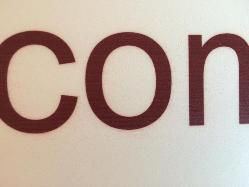

I'm having printing Majenta, letters are smudgy. Printing with SP Versacamm

clean the encoder strip and do a nice thorough head cleaning. if not, try a head soak. most of the time it has been the encoder strip for me.
Ragnabrok
Banding and overspray. a nozzle check would probably show deflection and missing nozzles. causes for deflection are usually cleaning related, wipers, surge mist sponge, wiper scraper. Missing nozzles is more to do with the cap(s), drain line and dampers.
