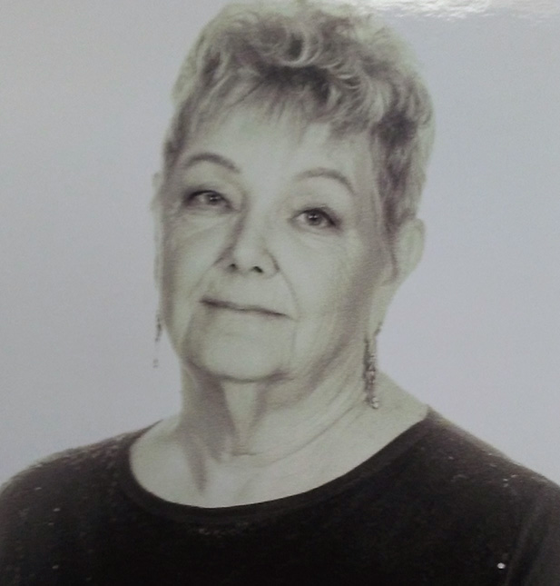

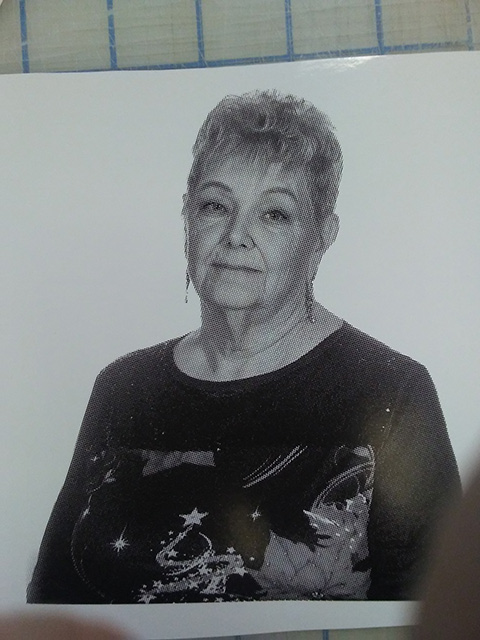

If you can't generate your own icc profiles, your greyscale image has a tint, and people are going to be viewing the graphic from more than a couple feet away -
Turn your image into a halftoned print (like a newspaper photo)
Open your raster file in Photoshop (if vector then first export the grey portions as a raster file)
Image-Mode-Bitmap
Output Resolution-Depends on how far viewers will be, figger it out
Method-Halftone Screen
Frequency-Again depends on viewing distance and what output resolution you picked earlier
Angle-Whatever (I use 22 degrees)
Shape-Round
That's it! Drop it back in your drawing program if mixing with vectors and output it from there.
For small stuff i.e. photos less than 2sq ft I use 600dpi and 50lpi
BONUS - your image won't shift colors as the various inks fade at different rates!
Edited for clarity and to add pictures to the explanation

I'm missing how this works? I mean, what is photoshop doing to fix the grey tint?
Yeah I never actually mentioned what I was doing (making halftones)! Sorry about that - I added some pics up top that should make it much clearer.

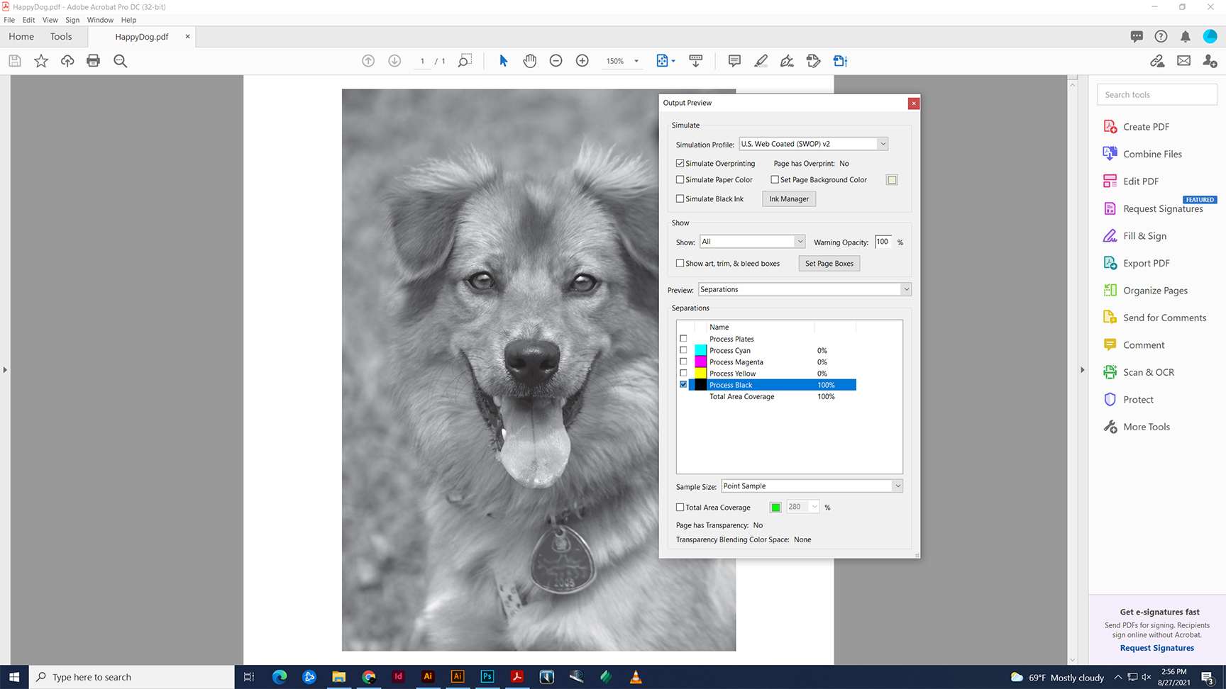

I was overthinking my last suggestion as I wanted to emphasize the ability to tweak the channels easily, but can't you skip the conversion to bitmap altogether if you use a greyscale tiff and place it into a CMYK Illustrator file? This is what I do.
You can triple-check things by looking at the output separation of your PDF in Acrobat and verifying that only the black channel has the 100k info you want.

Wish I knew more about Corel! I think the key is that it's a greyscale TIFF. Jpg or other formats will not work as far as I now. You also can't do it in an RGB document, so make sure it's CMYK when you start, before you place anything.
I get a lot of B/W images from folks that "look" greyscale but aren't. So it's always worth checking that it's truly desaturated or saved as greyscale (had the color data removed), since we all know it doesn't take much to lean into looking greenish or reddish.
Yeah having the ability to double check the channels in Acrobat is really nice until it becomes second nature. Maybe that's something you can verify in the RIP too?

I'm not sure if people understand that OP is turning B&W images with grey tones into a halftone pattern with only black dots.
When you print the image. the printer will only print solid 100% black (not black ink, but 100/100/100/100 or 95/90/85/90 or how ever your cmyk output is for 100% black) for the black dots, no matter how big or small they are.
Does it work? Yes it does!
