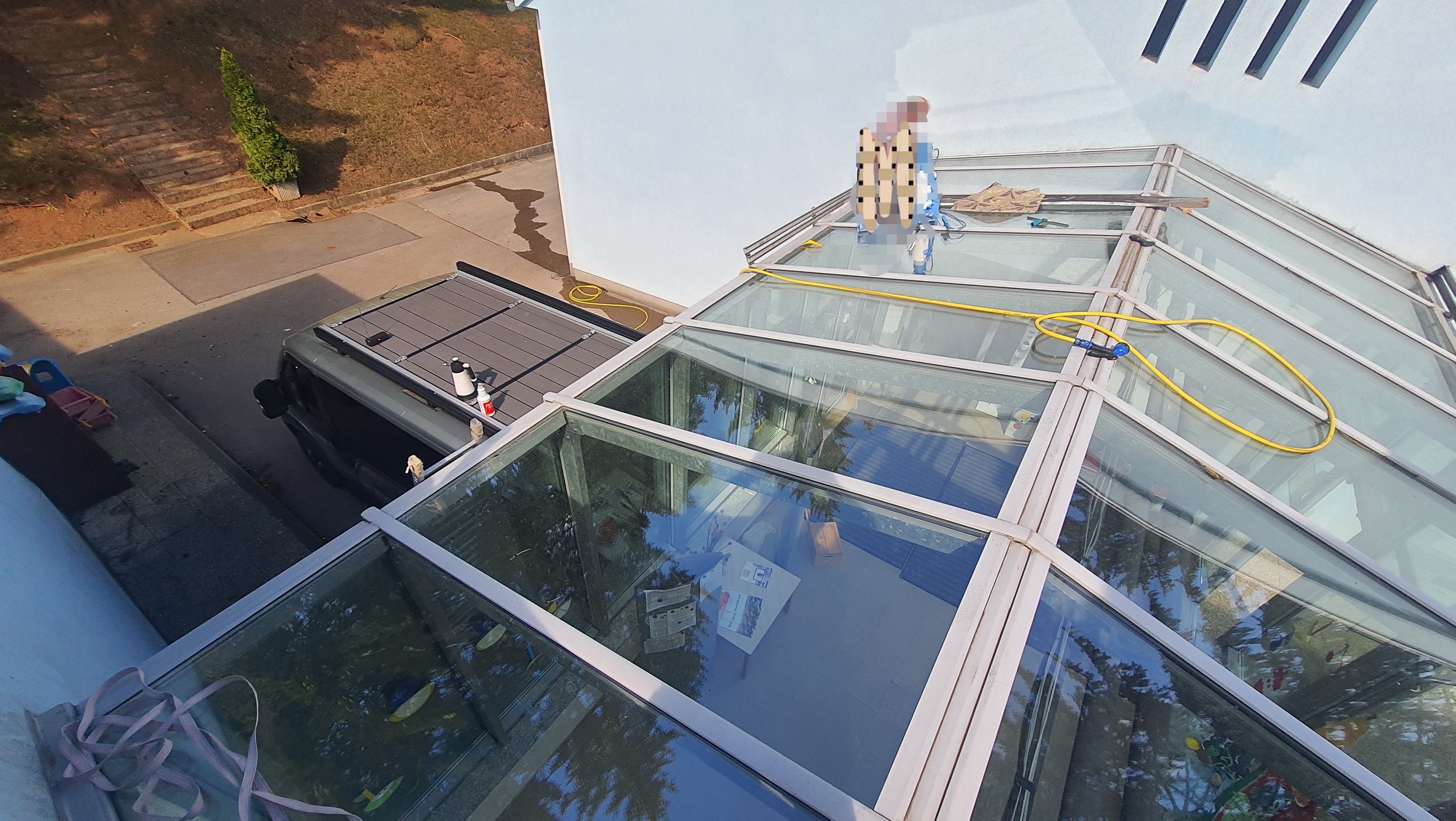

so i have finishedthe job. 2 person around 10 hours.
it was this glass "air-lock entry". with glass roof on top. it was quite difficult to install it on that aslant roof...

You installed the film on the exterior...? ...Was it a exterior rated film ? ..did you caulk the edges afterwards?
yes, on the exterior. i couldnt install it on interior, becouse there is many hoses going under the roof. Ofcourse it exterior rated film.
No, i didnt caulk edges. i leave a 1mm gap around between rubber and film... will see how long it will last.
Never saw tint go on the outside before
its not tint, its uv solar.
