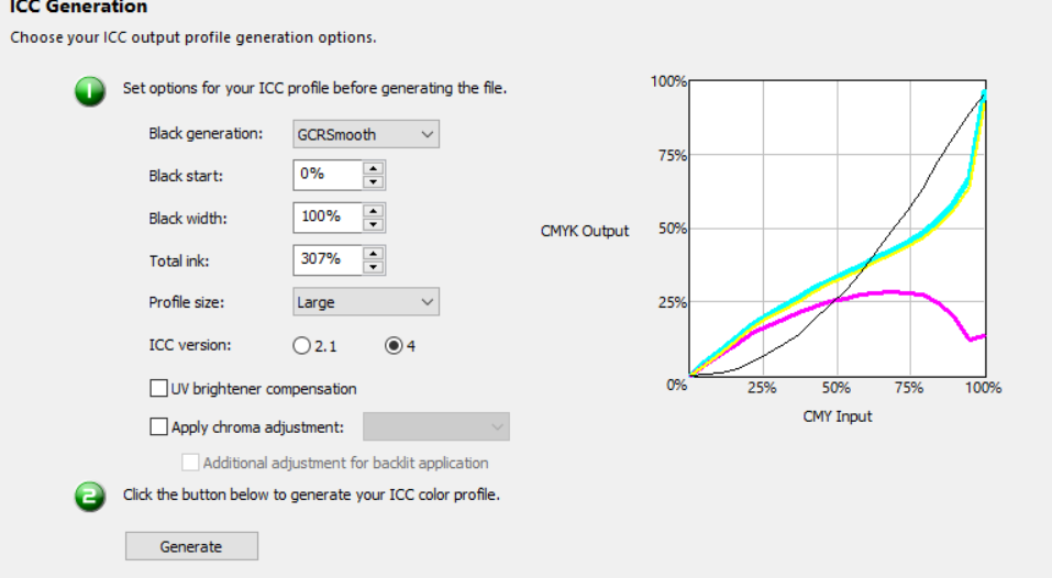

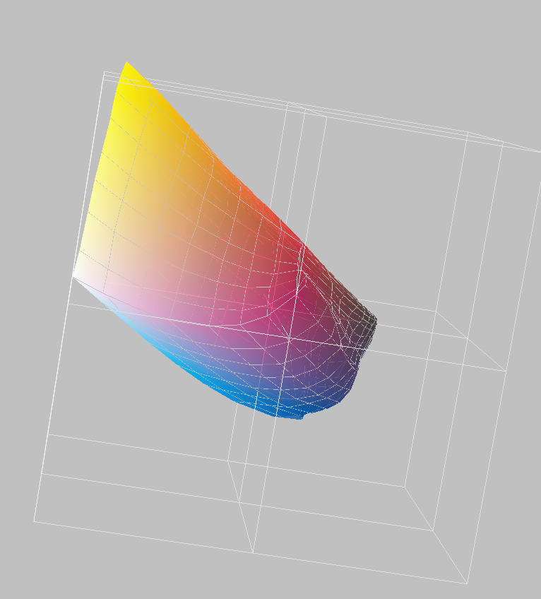

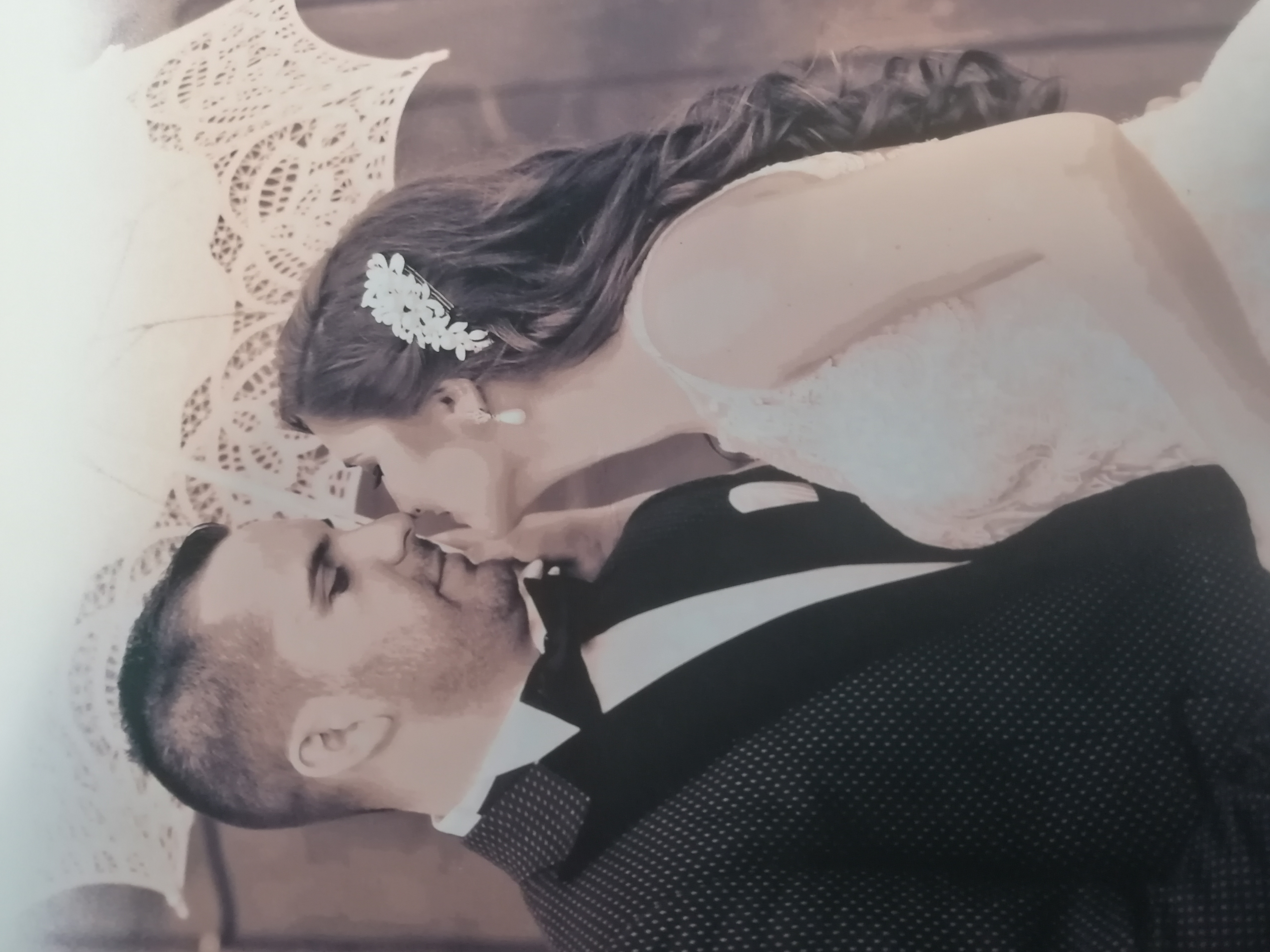

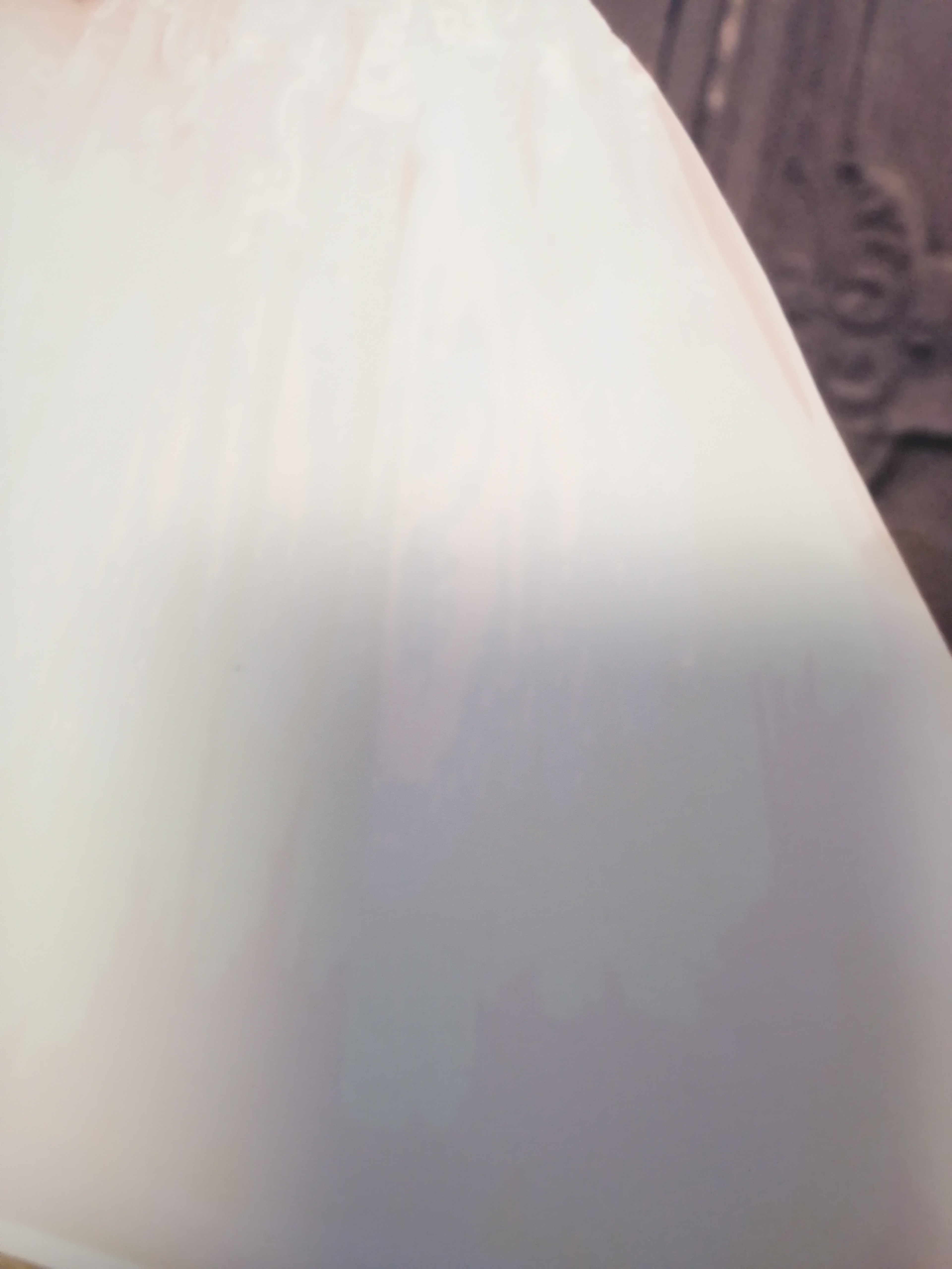

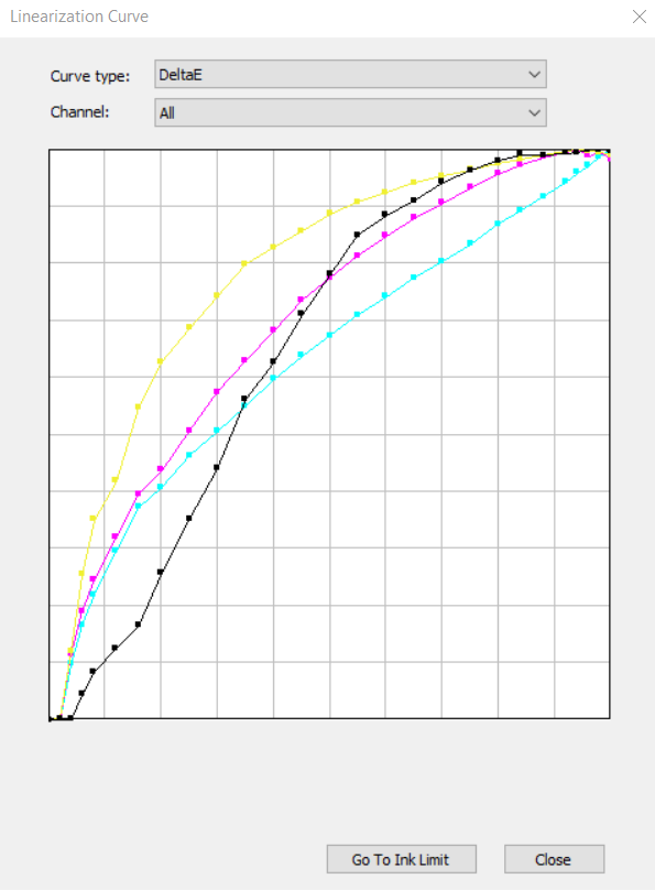

I have just make a new profile for my Epson SCT 5200
When I print my prints look solarized. It is not the first profile I make, but the first with this problem.
I admit I forced the printer a little
Flexi settings:
2800 x2800
media other
print mode quality
Color mode matteBkCMY(1bit)
KF diffusion
