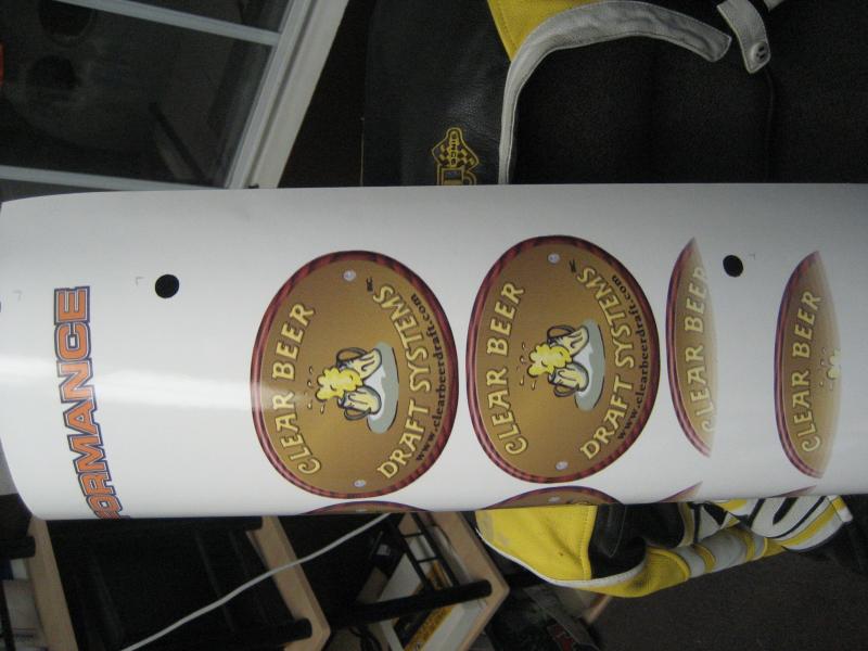

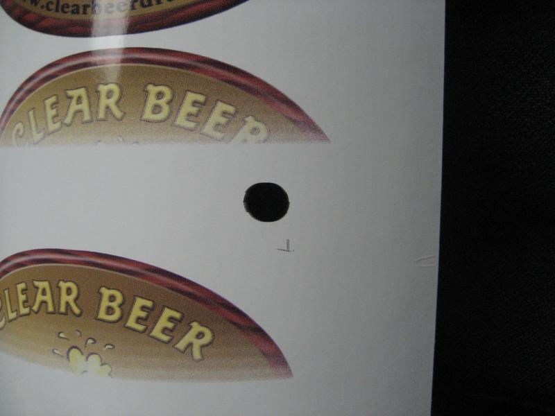

My Roland XC-540 Pro III was working beautifully, or as well as can be expected until this past week. Now all of a sudden - with NO head strikes - Now my cropmarks are blurry, and the cutcontour is off by a mile.
ANY ADVISE WOULD BE GREATLY APPRECIATED

Can you view the attached file? Let me know what you think.

cgsigns_jamie
Did you adjust any settings on the printer or did the just start happening out of the blue?
I was going to say that maybe the feed calibration was incorrect but I didn't see any banding in the print.

I adjusted everything and in all the tests it all looks good. There's something funky happening and It's hard to explain. A straight print is looking pretty good too. I'm using versaworks for the rip and I'm not sure if that's where the problem lies. I re-installed the program and everything. Strange and annoying.
