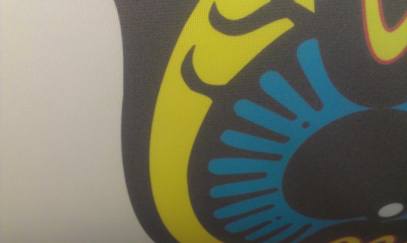

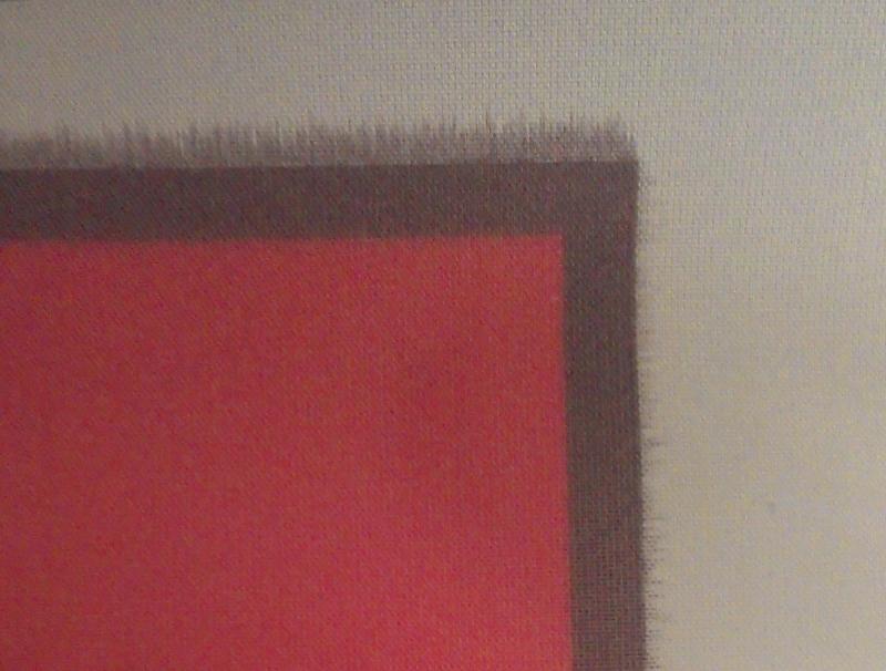

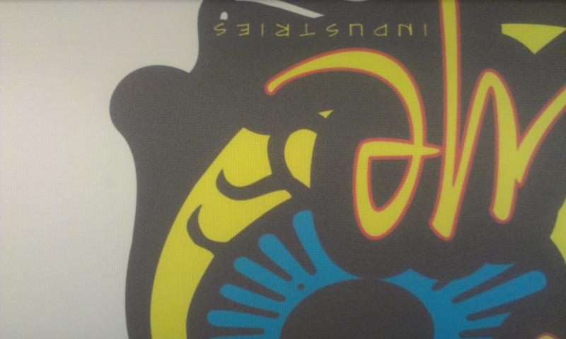

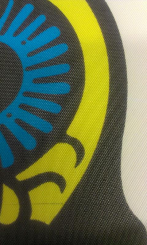

Here is the updated test reports:
1st photo is the 210 (too thin for us to use) YMMV
2nd & 3rd photo is the 310 (very nice and lightweight)
4th photo is the 70 (this one produced the best color for us)
All of them are new to us and we only had a short window for the job.

SightLine
