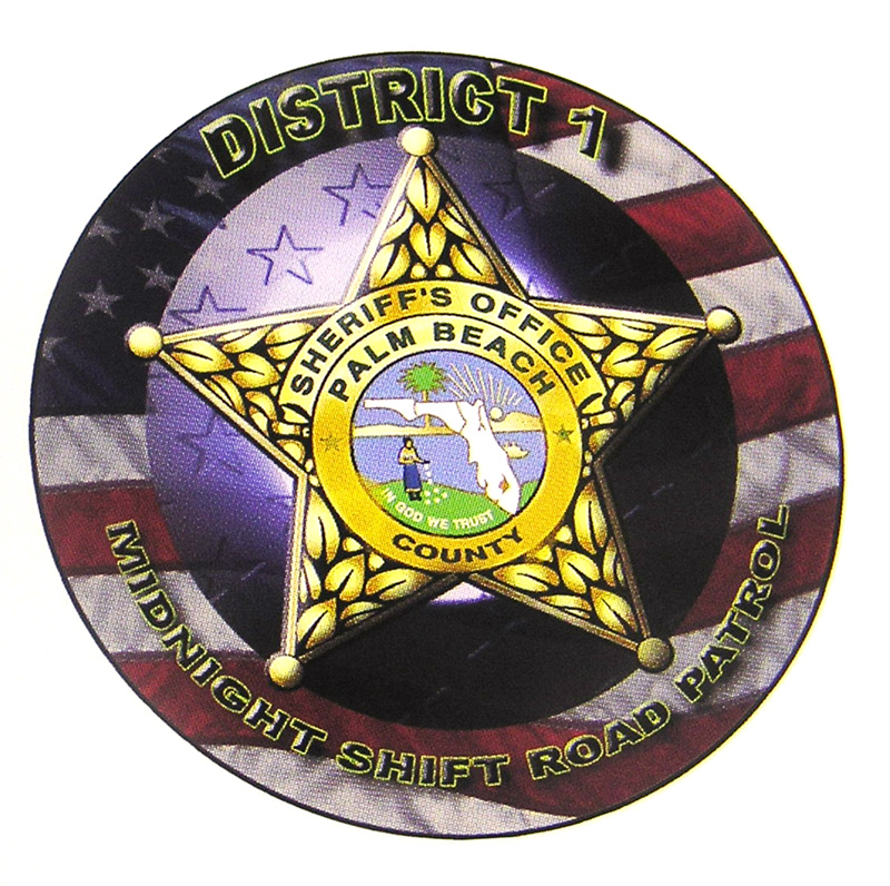

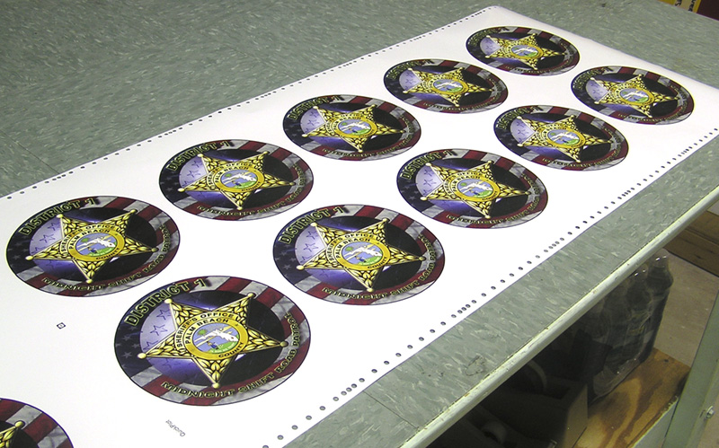

You may simply need to keep in mind that the Edge produces prints for signage ... not magazines. Output is intended to be viewed from more than half an arm's length away. Back in the day when ScotchPrint was king, I was put off in the same way when I got too close to a bus wrap at 100 DPI. But it looked great from three or four feet away. Same is true for outdoor advertising billboards printed as low as 20 or 30 dpi. Get up on the platform and you sometimes can't even make out what is printed.
The trick with the Edge is to use the best halftone when possible and to bump the LPI up to 70.7 (a harmonically natural setting for the printhead). Also use an image that is at least 72 PPI at the production size of the print ... 100 PPI is considered ideal.
In the example attached, you will see some graininess in the single closeup, but from three feet away it looks fine. The visible halftones provide the tonal quality needed for the art to work and have depth. We've had at least a dozen reorders on this job from front license plates for county police cruisers.
