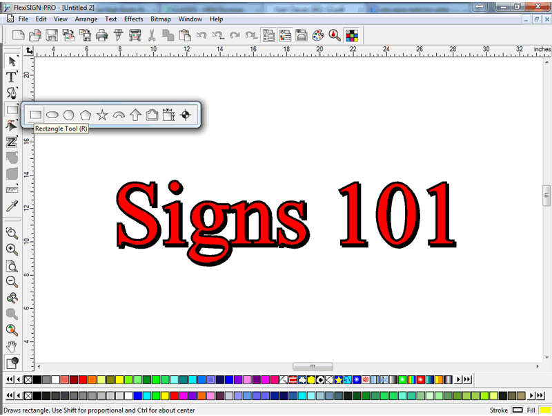

Is this similar to how you are trying to do it?
DizzyMarkus
lol on your first pic -- look all the way to the right once the shape menu opens -- you'll see the real regisatration mark simply click it to select and click anywhere around image to place it -- no need to seperate the colors, Flexi does it for you :0)
