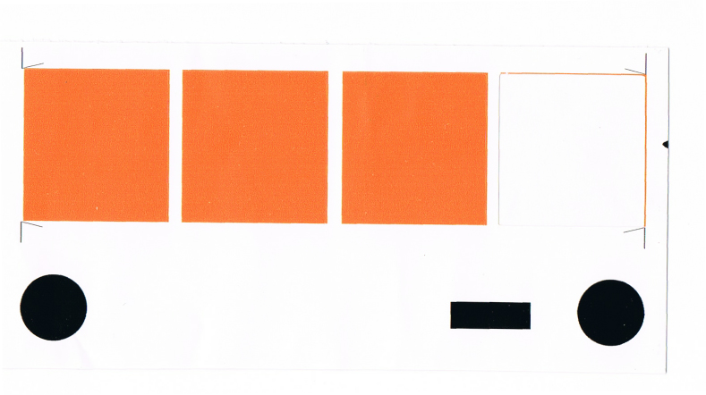

I spent the better part of 12 hours taking apart my machine and cleaning the encoder strip, the strip sensor, the sensor on the cutter. Did the environment match. Did the print-cut auto alignment as well as the manual alignment. No matter what I do the result is the same. (pictured below) Normally this wouldn't be a problem for most jobs but I have to do small circular stickers and they look like sh*t and its for a record label.

there are 2 adjustments
normal print and cut adjustment in the user menu
cut to alignment marks is in the service menu. on most roland machines.
